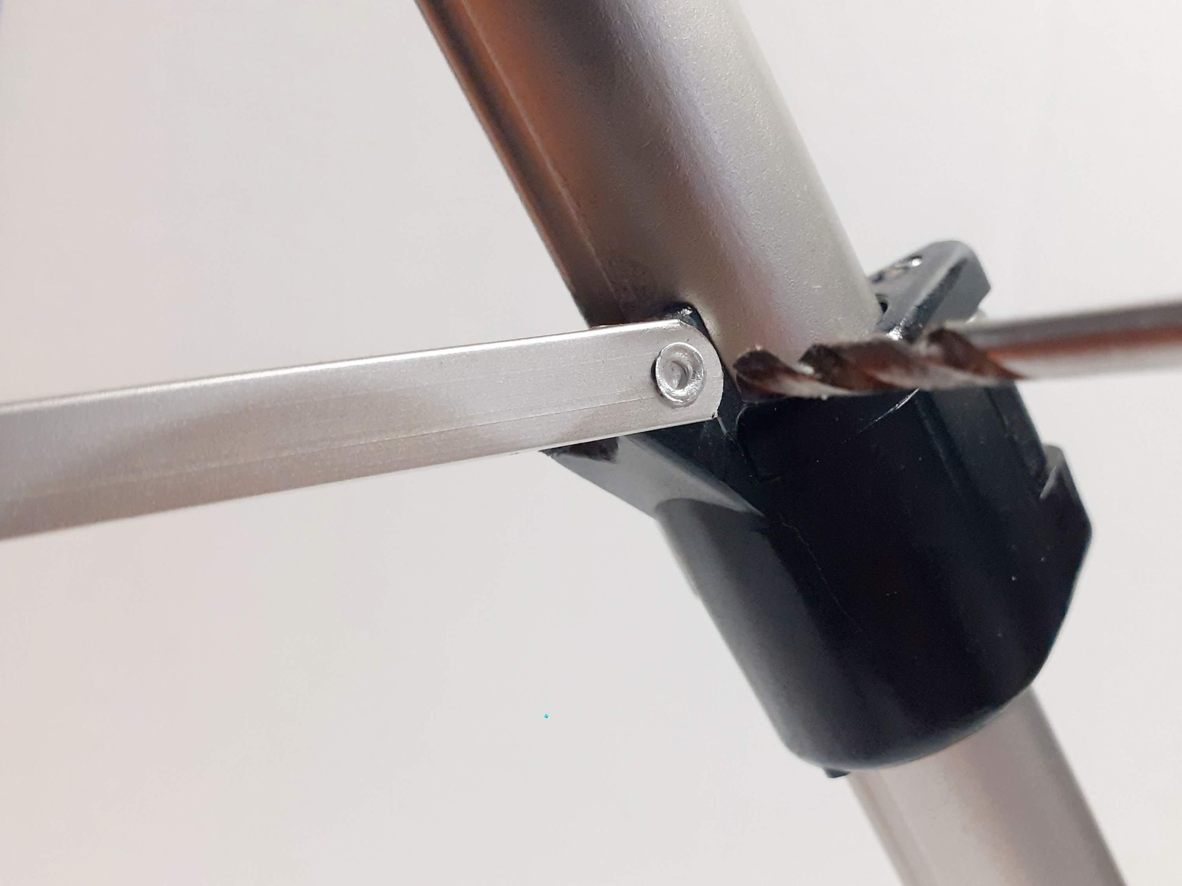

• If your tripod has Equilateral Legs (in red), then you'll have to remove the triangular structure (made up of three 'balance arms') from the leg before you can proceed. To do this, lightly drill onto the crimped end of the rivet that holds the leg to the balance arm.
• Then you will be able to push the rivet out the other side, freeing the leg from the balance arm.

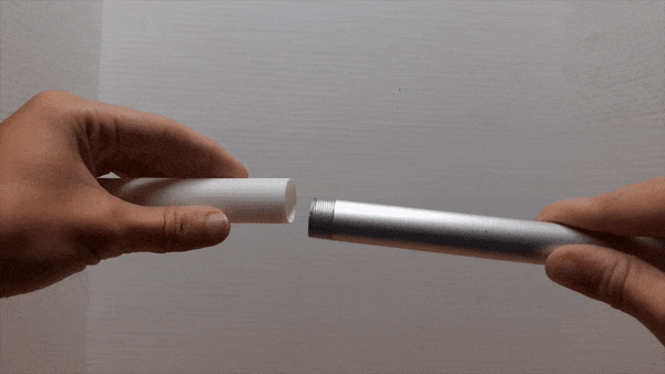

• Now, to unscrew the leg from the tripod body, firmly grasp the tripod body with one hand. With the other hand, firmly grasp the leg using pliers, and begin unscrewing the leg from the tripod body.
• Once the leg is fully unscrewed and is detached from the tripod body, you can put the rest of tripod aside.

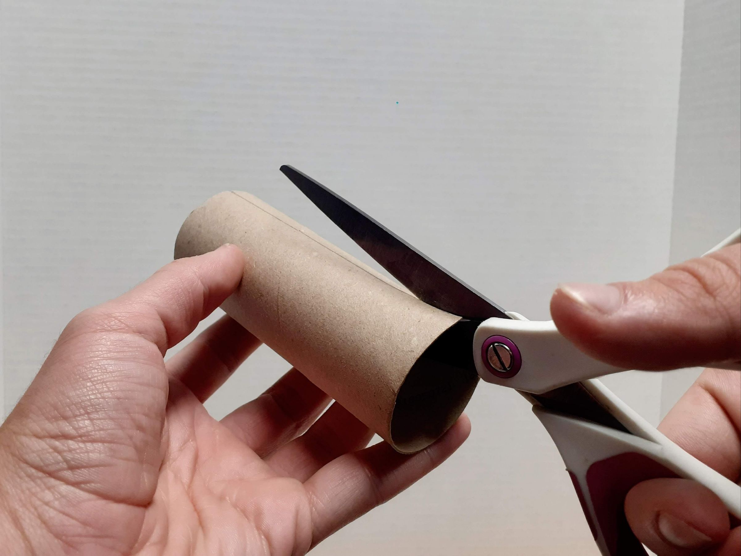

While you can try to wrap a sheet of cardboard around the top of the tripod leg, it is much easier and more readily-accessible to use an empty toilet paper roll, so that is what I'll do in this Instructable.

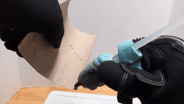

• Using a pencil, draw a straight line down the side of the roll, and then use scissors to cut along that line.
Now you're ready to make the toilet paper roll into the handle.
Have your paracord readily accessible.

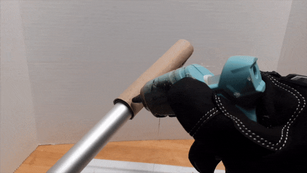

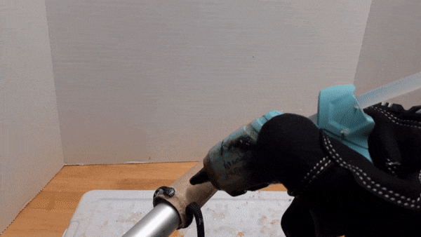

Heat up your hot-glue gun and put a hot-glue stick in it. Be sure to wear heat-resistant gloves.

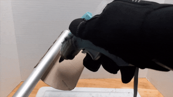

• Then squeeze out a line of hot-glue along one of the edges of the roll, and press the roll onto the tripod leg.
• Wrap the roll around the tripod leg, gradually adding hot-glue every few inches, until the roll is fully wrapped around the tripod leg.
• At the base of the roll, apply a ring of hot-glue, and wrap the end of the paracord around it.
• Lightly glaze the roll with hot-glue, and then spiral the paracord around the roll until you reach the top.

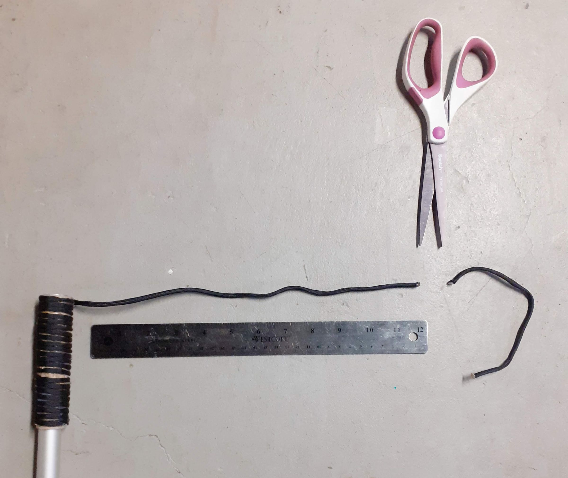

• Leave an extra 12in (30.5cm) of paracord, and then cut off the access length of paracord.

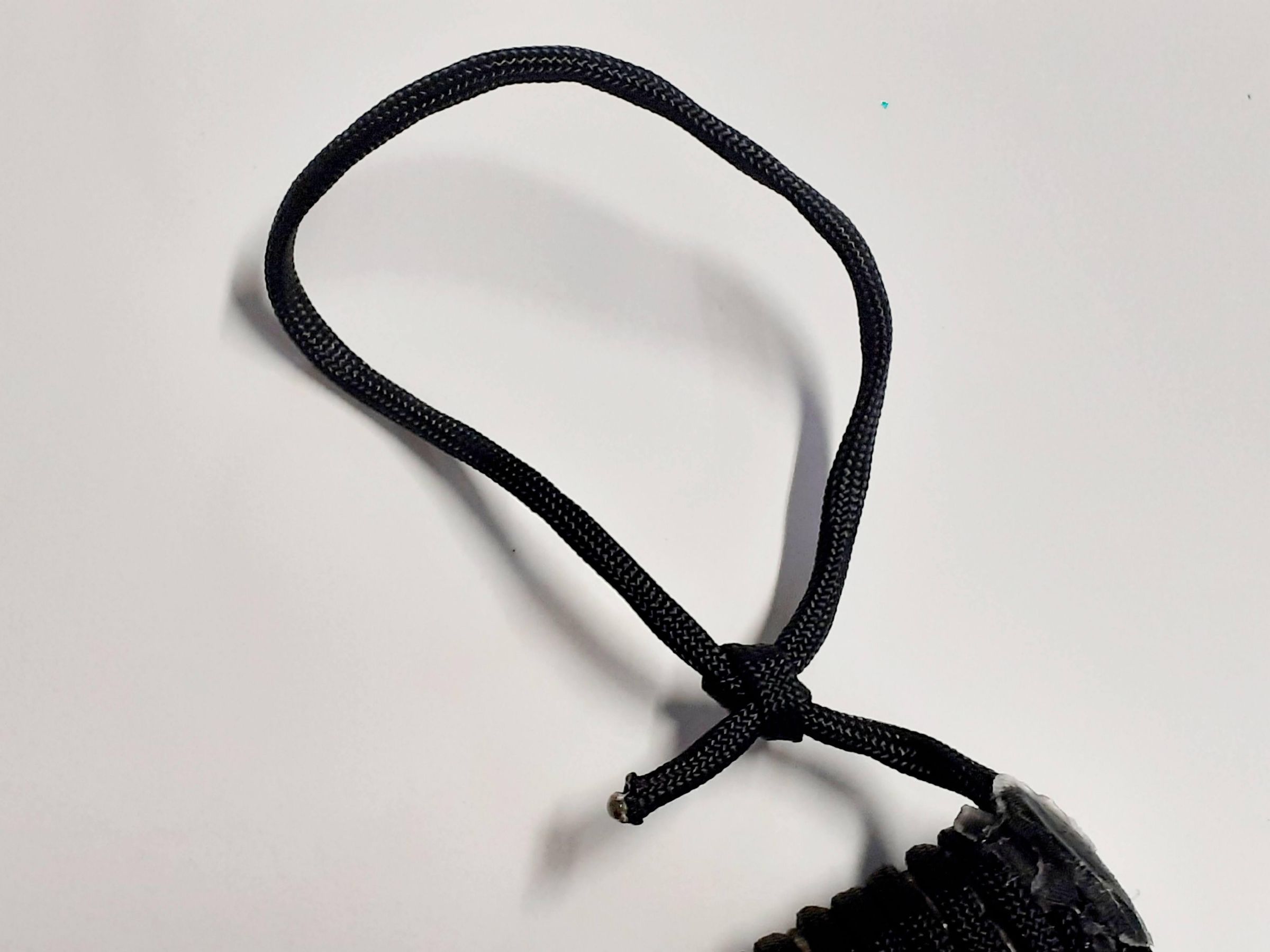

• Using the extra 12in (30.5cm), tie a two-half hitch knot to make an adjustable wrist strap.
↳ Image Credit: Scout Handbook, Boy Scouts of America.
• If you don't want a wrist strap, then you can simply cut off the extra 12in (30.5cm) of paracord.

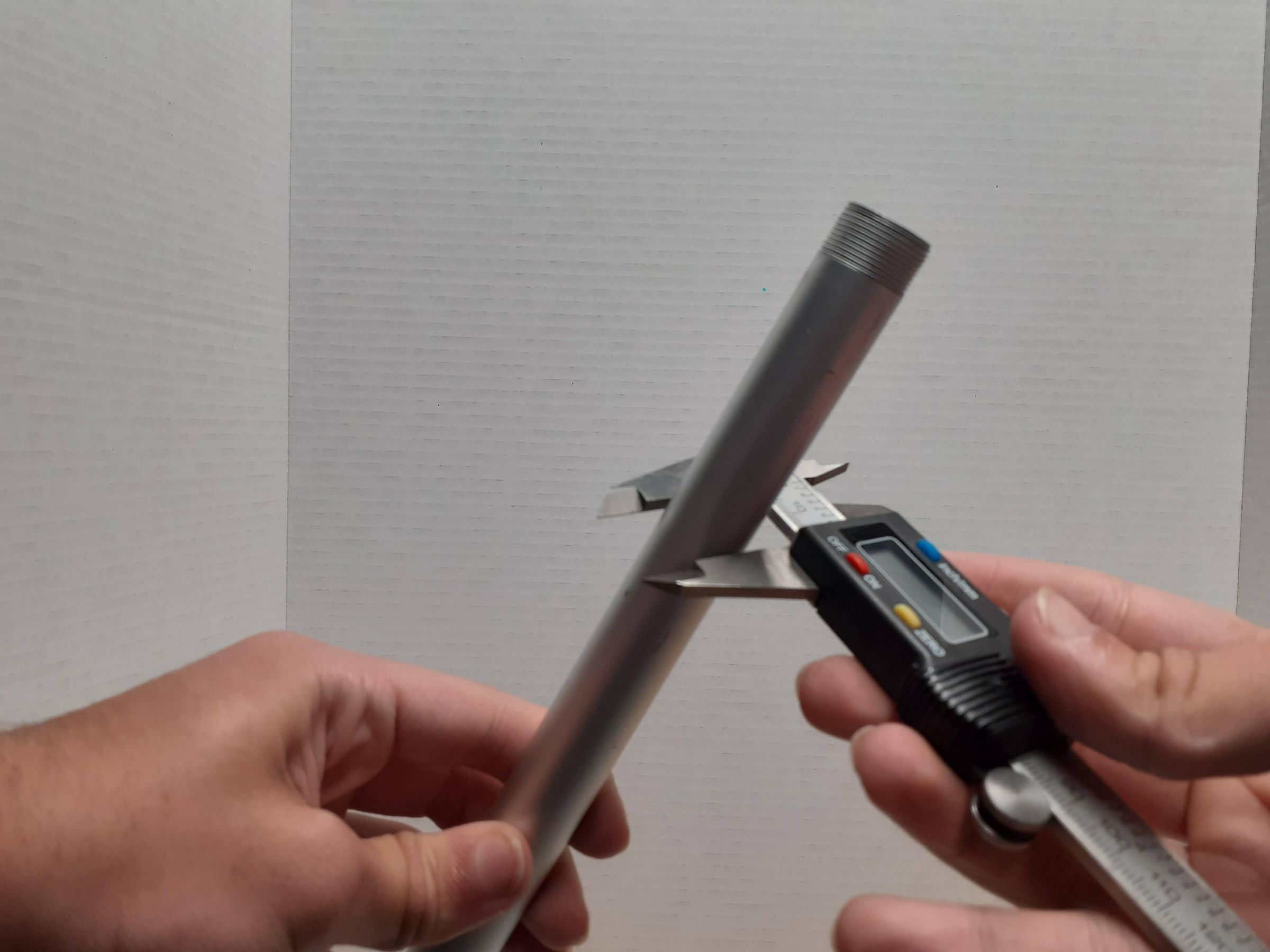

Step 3: (For 3D Printed Handle) - Measure the Tripod Threading

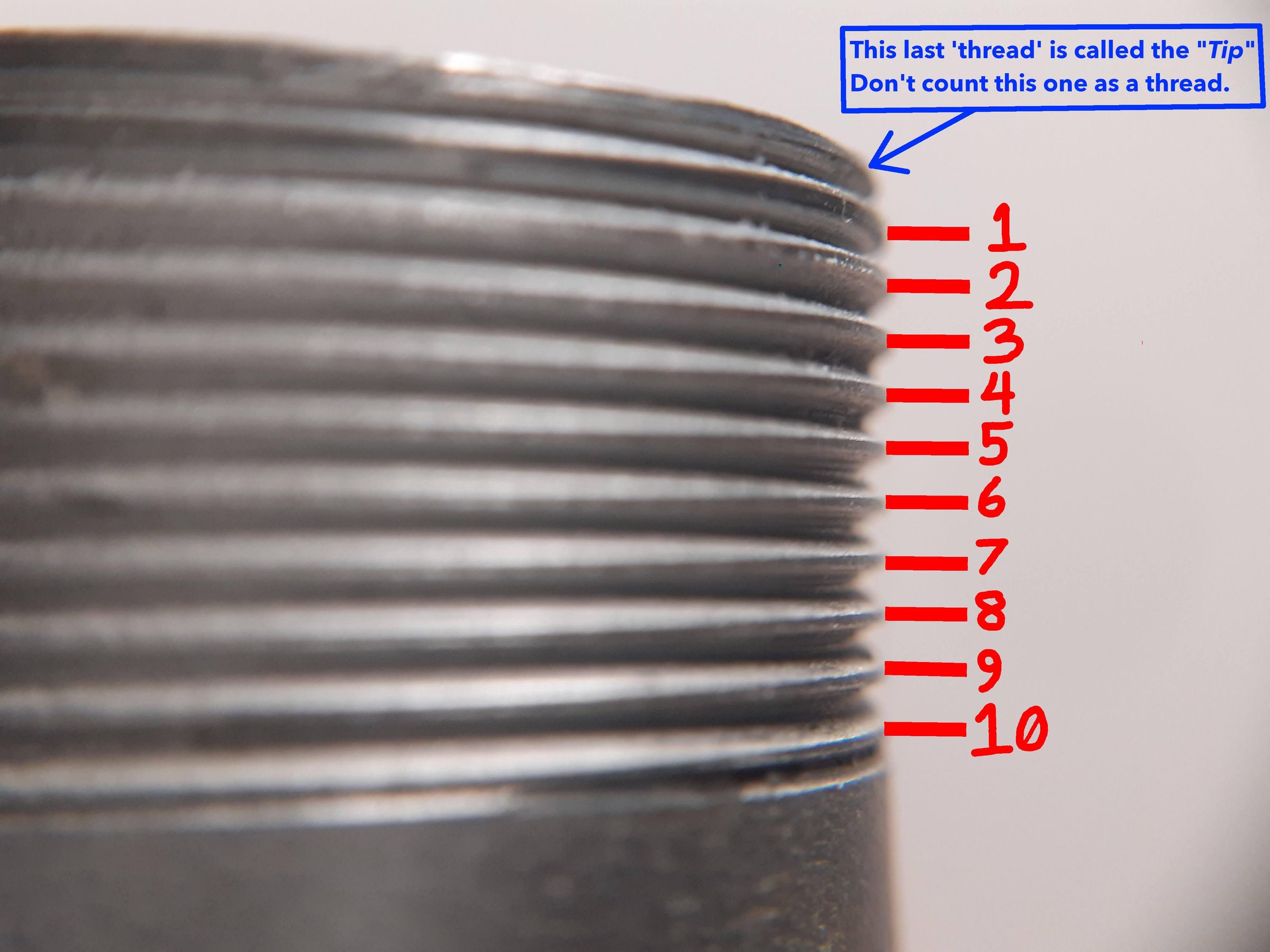

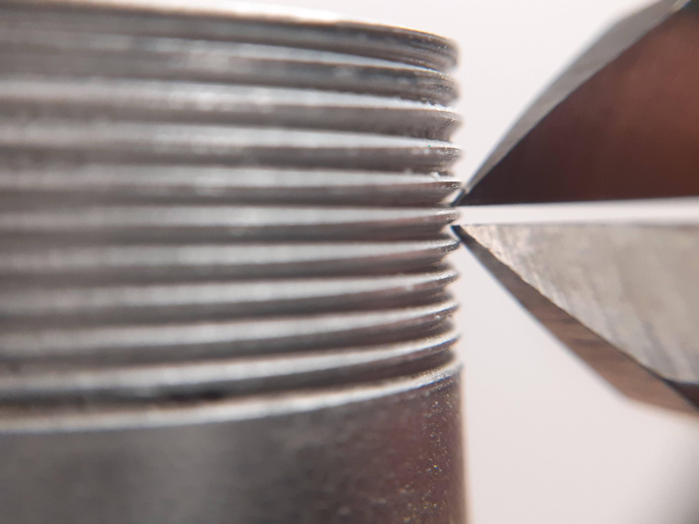

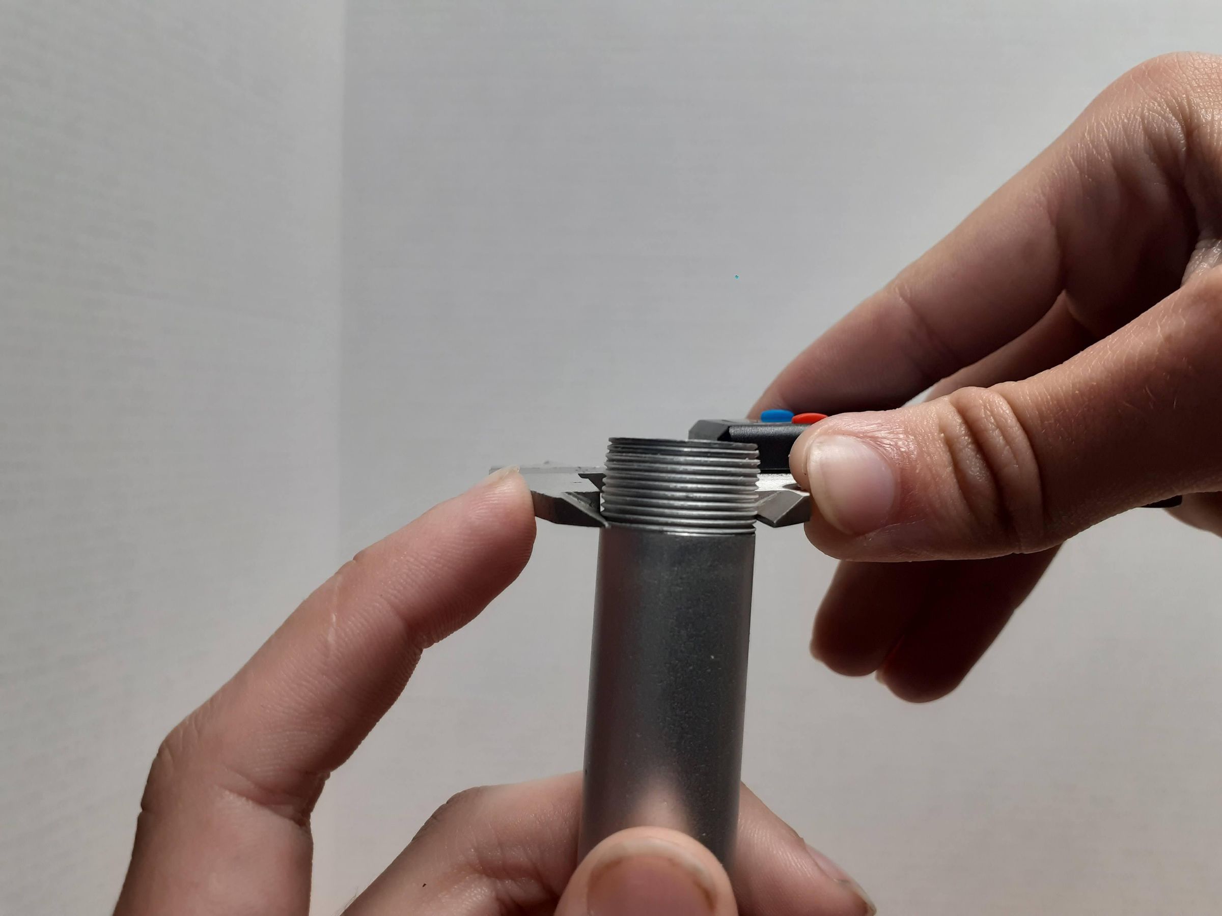

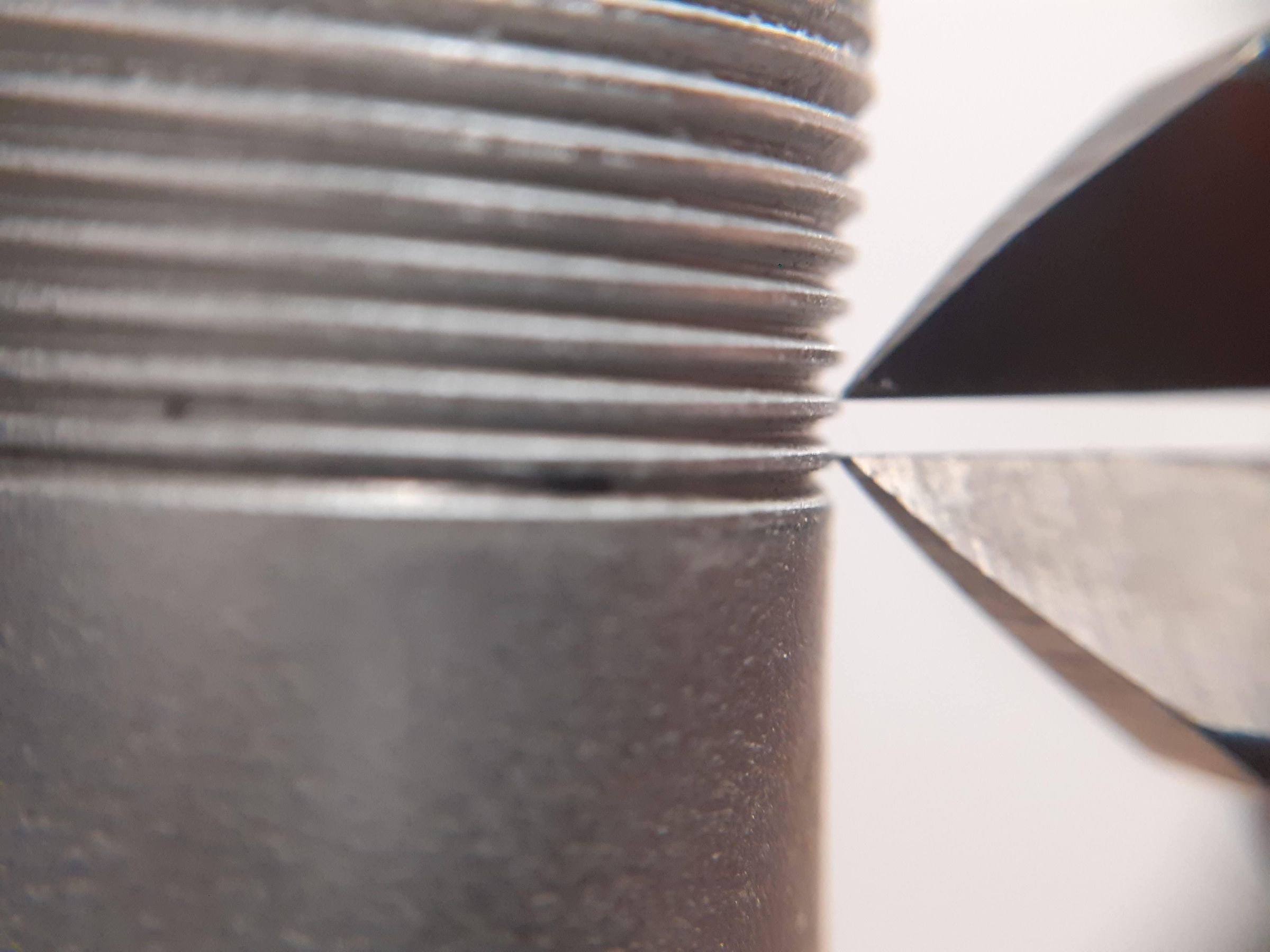

The threading and the pole diameter on your tripod leg may or may not have the same measurements as mine (my measurements are listed in Step 4). To check this, you will need to measure your tripod leg with electronic calipers as follows:
• Pole Diameter: Measure the diameter of the outermost rod of the tripod leg.
• Thread Diameter: Measure the diameter of the crevices of the threading.
• Thread Pitch: Measure the distance between the center of one thread to the center of the thread above it.
• Thread Scale: Measure the vertical thickness of a thread.
• Thread Rotations: Count how many threads there are.
• Thread Segments: Doesn't matter. [But if you are going to be adjusting the Tinkercad file, set the value to 16]
• Thread Tip Scale: Doesn't matter. [But if you are going to be adjusting the Tinkercad file, set the value to 0]
• Thread Tip Segments: Doesn't matter. [But if you are going to be adjusting the Tinkercad file, set the value to 3]

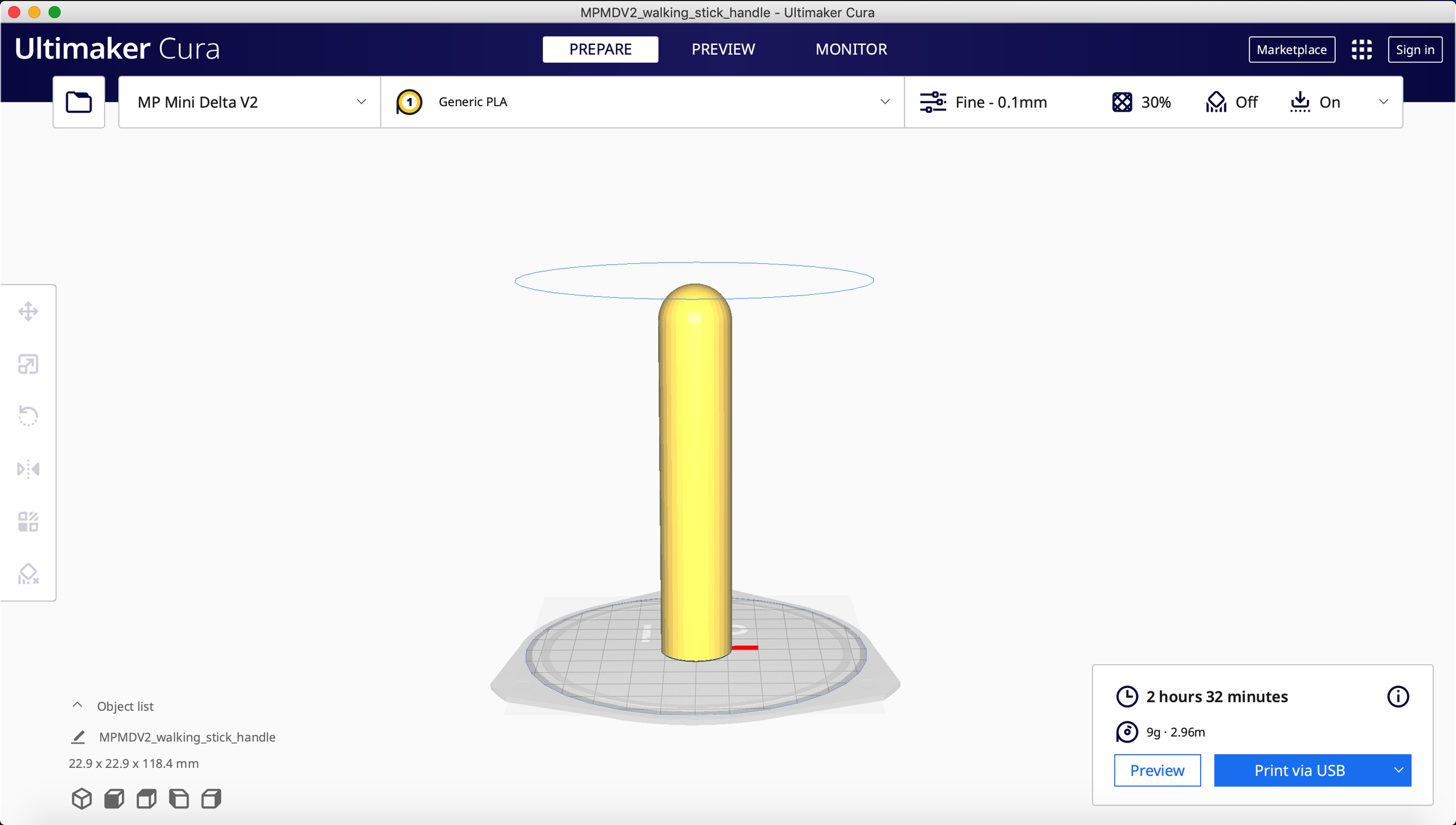

Step 5: (For 3D Printed Handle) - 3D Printer Settings
I use the Monoprice Mini Delta V2. This printer has, by default, the following specifications:
• 110ømm x 120mm build area
• 0.4mm nozzle
• Bowden Extruder
The plastic I use is PLA plastic from the brand Overture.
↳ Amazon link for Overture PLA plastic used in this Instructable: OVERTURE PLA Filament 1.75mm PLA 3D Printer Filament, 1kg Cardboard Spool (2.2lbs), Dimensional Accuracy +/- 0.03mm, Fit Most FDM Printer (White 1-Pack)
I use 3D slicer software called Ultimaker Cura for my printing settings.
For the walking stick handle, the settings are as follows:
• Profile: Fine - 0.1mm
• Quality
↳ Layer Height: 0.1mm
• Infill
↳ Infill Density: 30%
↳ Infill Pattern: Gyroid
• Material
↳ Printing Temperature: 220ºC
↳ Build Plate Temperature: 60ºC
• Speed
↳ Print Speed: 48mm/s
• Support
↳ Generate Support: Off
• Build Plate Adhesion
↳ Build Plate Adhesion Type: Raft
↳ Raft Extra Margin: 2mm
↳ Raft Air Gap: 0.25mm
Any settings not mentioned in that list can be left at the default settings.

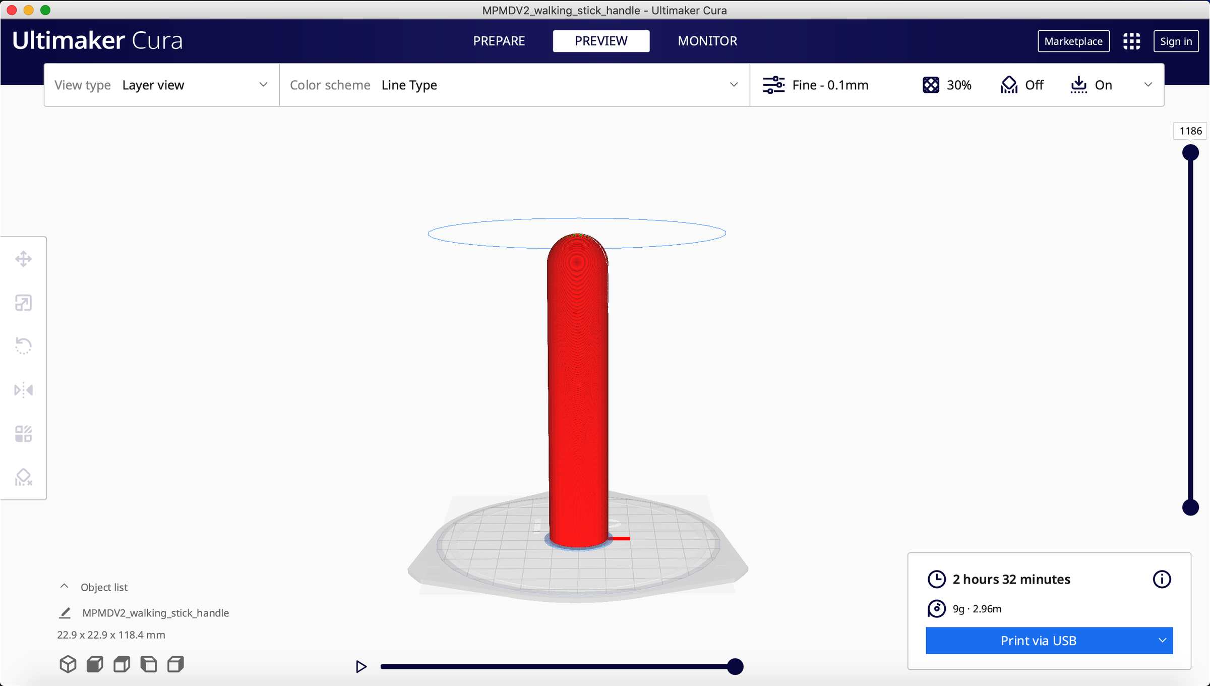

For your convenience, I provided a screenshot of the Print Settings menu (above).
Here are what the 'Prepare' and 'Preview' screens look like for me:
• Prepare:
• Preview:

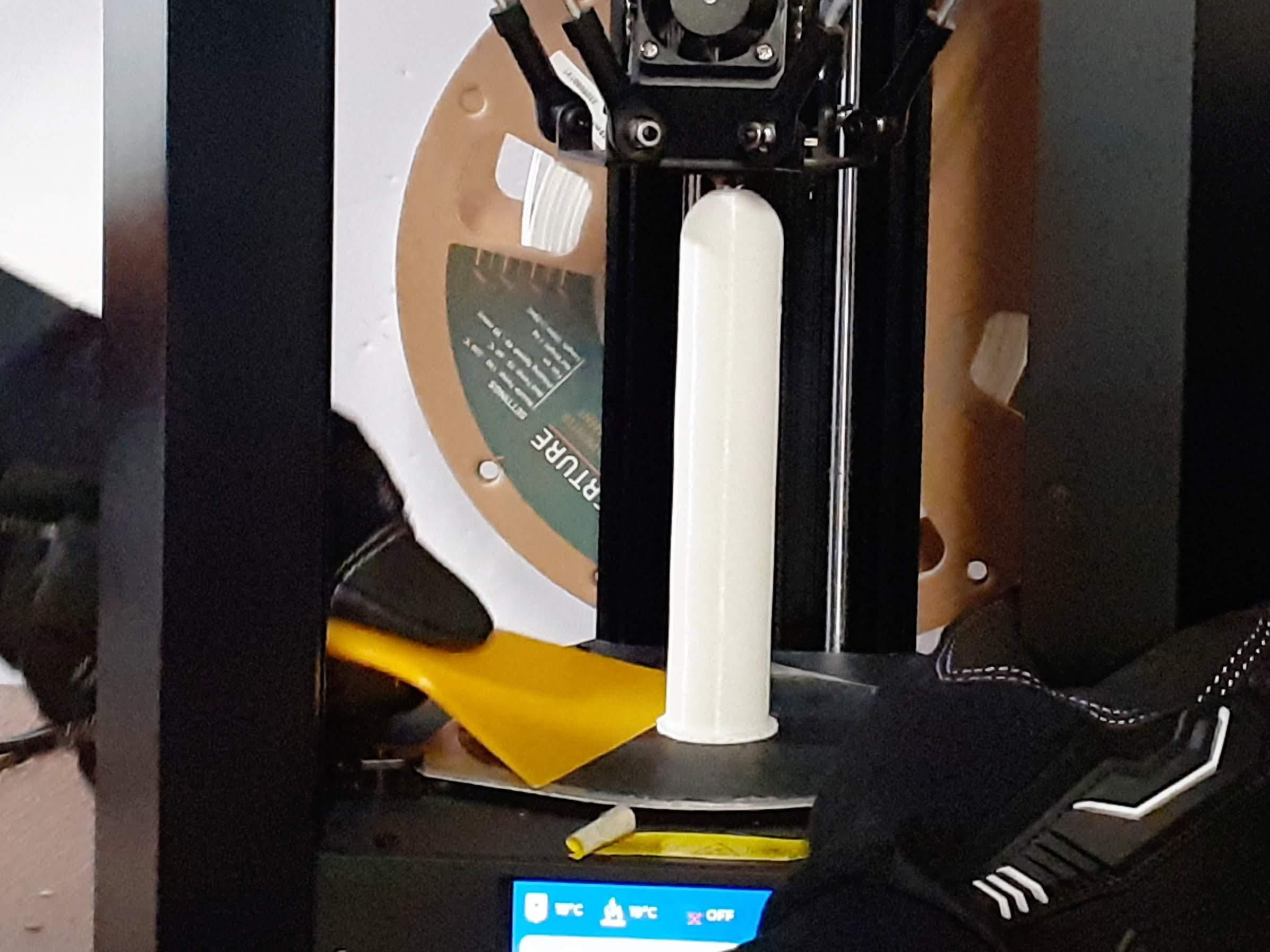

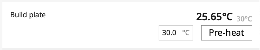

After the handle is fully printed, let the print cool down for about 5 minutes. Then, using the Pre-heat tool in Ultimaker Cura, pre-heat the build plate to 30ºC and wait for it to reach that temperature.
• Once the build plate has heated up, put on your heat-resistant gloves and use the scraper tool to gently pry off the printed handle from the build plate.
• Then gently peel off the raft from the bottom of the handle.

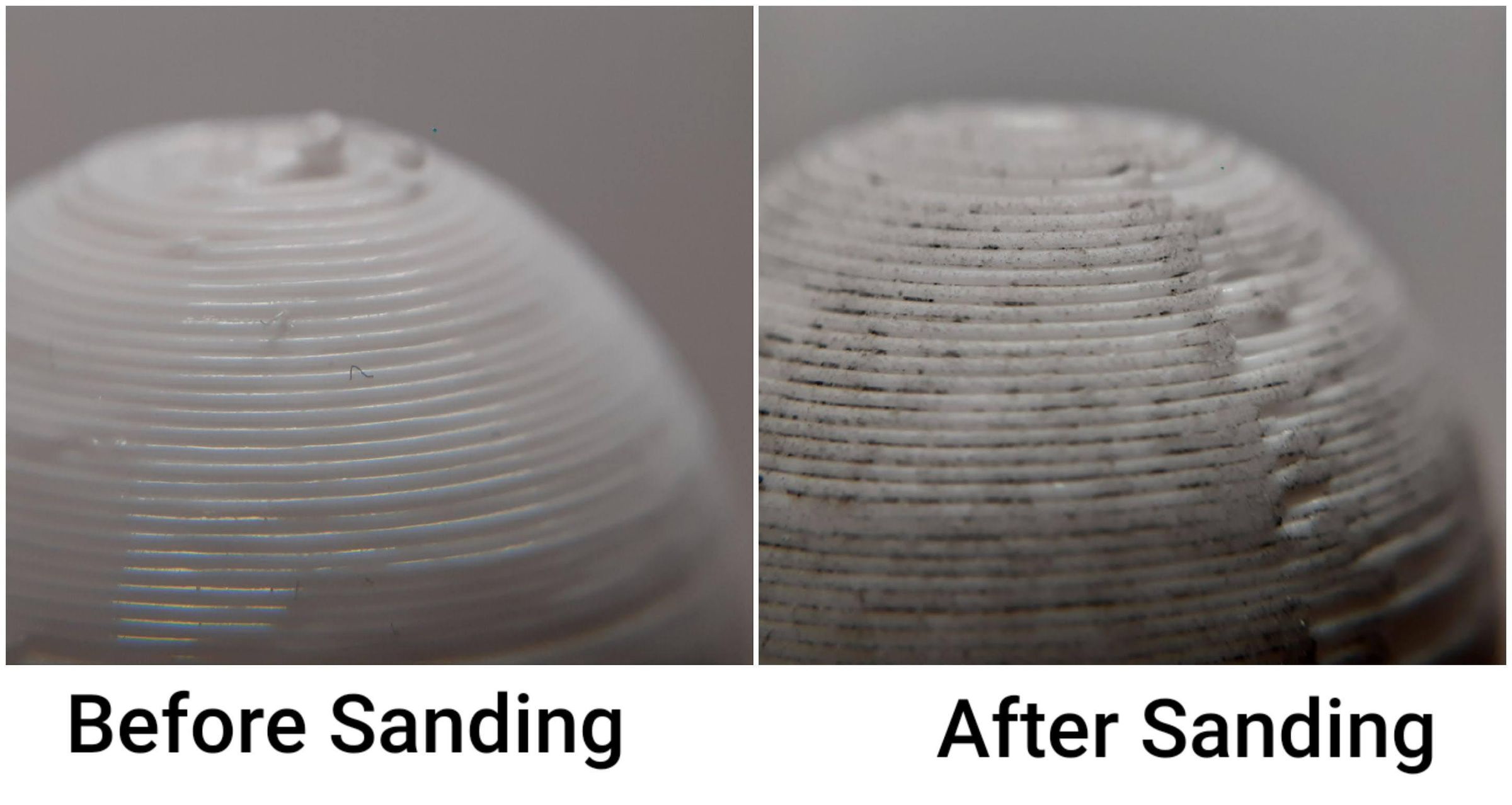

• Use the 240-grit sandpaper to sand the outer surface of the printed handle.
• Now screw the handle onto the tripod leg, to make sure that it fits the threading (and make sure that it can be a tight fit too).

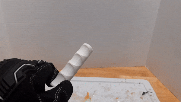

Step 7: (OPTIONAL) (For 3D Printed Handle) - Ergonomic Grip
This step is OPTIONAL. If you want to make the 3D printed handle easier to hold onto, then follow this step. If you like the handle as-is, then you can skip this step.
First, download the 3D file called "walking_stick_grip.stl" which is attached to this step.
The print settings are the same as in Step 4, and the post-printing process is the same as in Step 5.
Once you have printed and sanded the grip, you can follow these instructions:
• Wear heat-resistant gloves.
• Heat up your hot-glue gun and put a hot-glue stick in it.
• Add a light layer of hot-glue onto the back (concave) side of the grip, and then stick the grip to the side the handle. Firmly grasp the handle and grip for about 5 to 10 seconds while the hot-glue dries.
