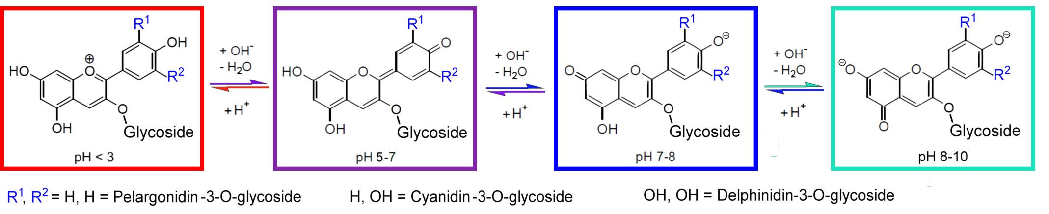

The name stems from Greek: ἄνθος (anthos) "flower" and κυάνεος/κυανοῦς kyaneos/kyanous "dark blue". They are found mostly in flowers and fruits, but also in leaves, stems, and roots. They are red or pink in acidic solutions, purple in neutral solutions, greenish-yellow in alkaline solutions, and colorless in very alkaline solutions, where the pigment is completely reduced [1].
As you can see in the image underneath the chemical structure and therefore the color changes with the pH value.
CC BY-SA 3.0 (the original image can be found here, remixed by me)
