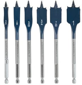

- Various hole cutter bits

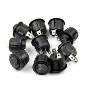

- Your preference for on off switch (I used the rocker switches in the attached picture)

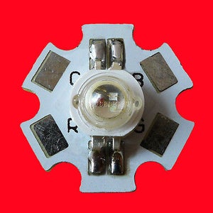

- 3W RGB Color High Power LED Light Common Anode with 20mm Star Heatsink

Use a spade bit the same size as your rocker switch to make a hole for mounting (or do whatever you need to do to mount the switch you've chosen)
Use a hole drilling bit (see picture) the same diameter as the acrylic tube to make a groove for the tube to rest in. Your LED will rest in the center of this circle. Inside this circle you'll drill four holes for you to feed wire from the electronics inside to the LED outside.

Solder a wire to each of the four pads on the RGB LED. Place the LED in the center of the circular groove on the lid of the box and feed the four wires through the four holes toward the inside of the box. I found that the wires held the LED in place just fine but you can add some hot glue if you wish.

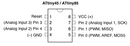

Wire power through your power switch to the common anode wire of your LED (marked C) and pin 8 of your ATTiny85.
Wire ground to pin 8 of the ULN2003AN and pin 4 of the ATTiny85.
Add your smoothing capacitor between power and ground. It should be rated over 5 volts and have a value around 10 μF
Wire ATTiny85 pin 3 (output for color RED) to ULN2003AN pin 1. Attach the wire on the LED's red pad (marked R) to the associated ULN2003AN pin 16 with one of the 10 Ohm resistors.
Wire ATTiny85 pin 5 (output for color GREEN) to ULN2003AN pin 3. Attach the wire on the LED's green pad (marked G) to the associated ULN2003AN pin 14 with one of the 10 Ohm resistors.
Wire ATTiny85 pin 6 (output for color BLUE) to ULN2003AN pin 5. Attach the wire on the LED's blue pad (marked B) to the associated ULN2003AN pin 12 with one of the 10 Ohm resistors.
