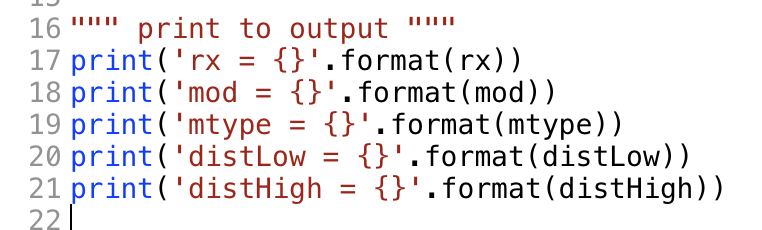

Step 2: Code Changes: Print All Parameters
I added a piece of code that prints all parameters whenever I create a new model.

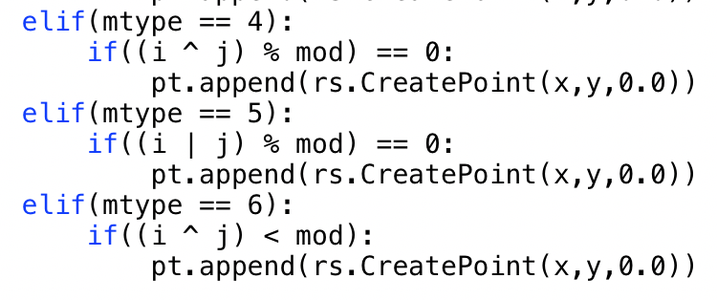

Step 3: Code: I Added Bitwise and Relational Expressions
Inspired by this post by programmer Martin Kleppe on Twitter, I decided to explore some bitwise boolean expressions to see what kinds of diverse patterns I could explore.
