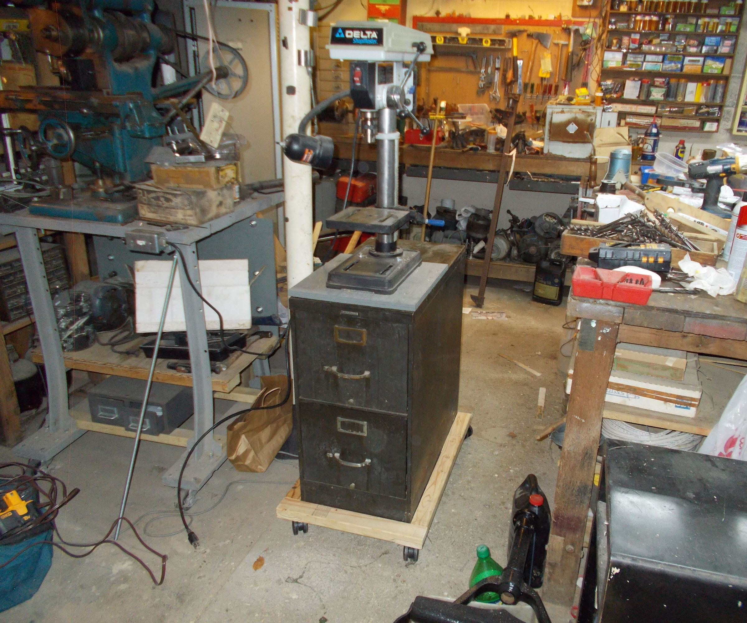

Metal Lathe ( It's a very simple turning and you may be able to make it on a drill press if it has a big enough chuck)
