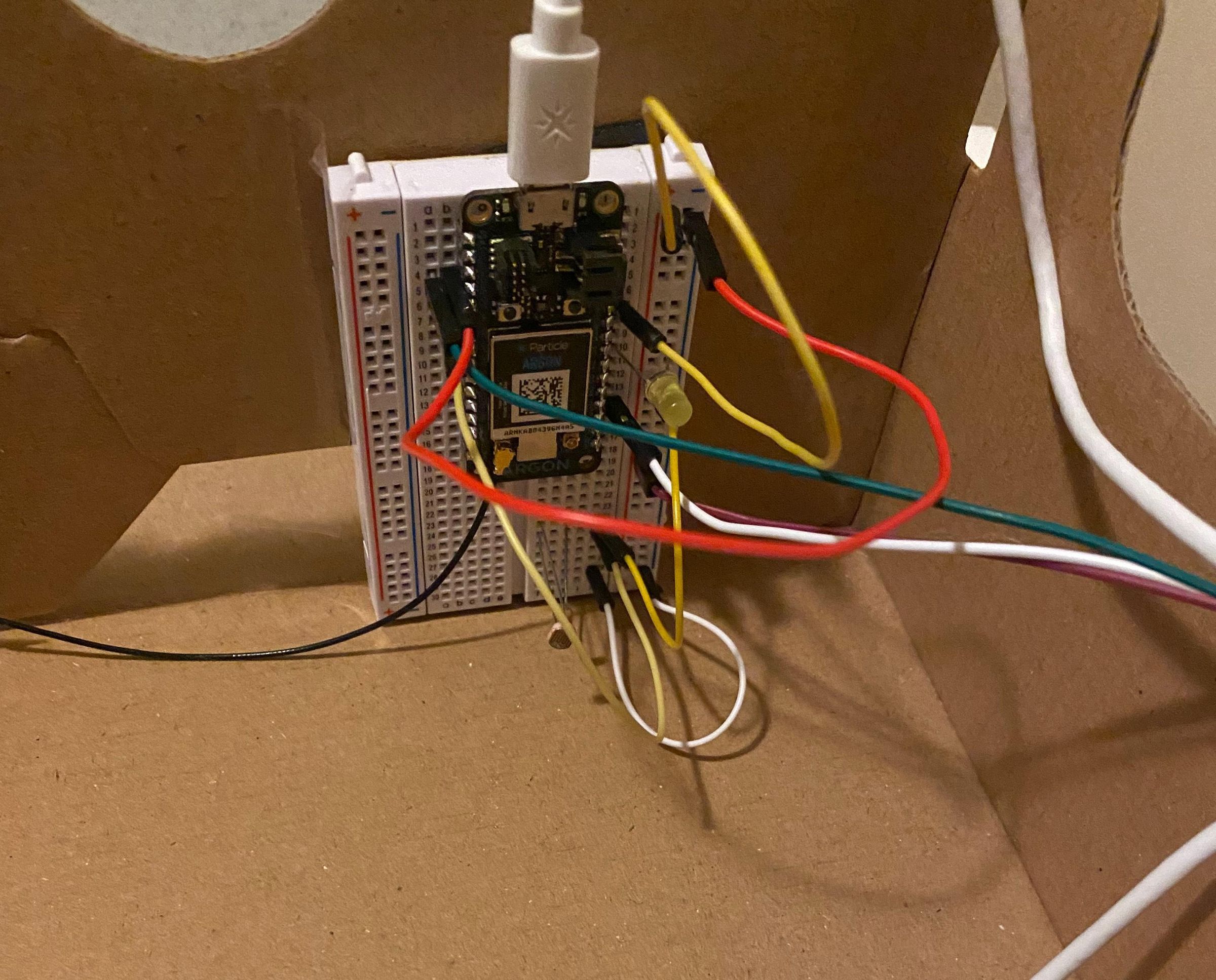

The Breadboard has the argon micro controller attached to it. The first step was to find everything that I was going to use and wire it up, in this case I had to wire a Stepper motor alongside it's control board to a Breadboard. I also attached small wires between the positive and negative ends of both sides of the rails.

To put all the finished wires and components I put the Argon and the Breadboard on the back of the box and hot glued them into place. I would then attach the moon to the top right of the back of the inside of the box and pokes holes right behind it to connect the wires to the Breadboard. I would then attach the police light LED strip to the police car and poke holes on the side of the box to then again attach it to the Breadboard. The inside of the box was created by my sculpture partner Ariana, which consists of a police car, half of a crashed car, a tree, grass, and the moon.

Link to video of the final project, the Stepper motor does not spin as intended, I have deemed the problem to be either a coding issue or the Stepper motor itself, I have ran test code on the Stepper and it does not spin at all, however the motor board seems to be fine as well as the wiring.
