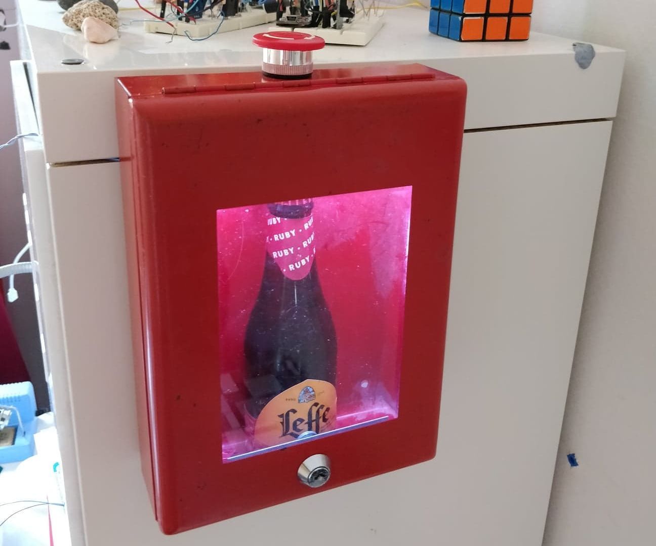

I made this box to "improve" my computer, with it you can switch the internet connection, audio output and microphone input. You can also turn on and off each fans of your computer case and control their speed even if they are not PWM-ready ! But that's not all !

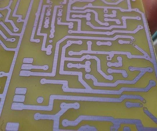

Step 3: Making the PCB
I made a detailed instructable on how to make a professional PCB. Just follow it to make the PCB. Or ask https://jlcpcb.com/ if you don't want to make the PCB yourself.
For soldering, start with ICs sockets in the middle of the PCB and then continue soldering all the components to reach sides. Finish by soldering fans connectors and potentiometers. All the components are soldered through holes except fans connectors.
The artwork I shared is made for 100*160mm PCBs to cut in half (to get 2 pieces of 50*160mm) once the PCB is made.

I use 3mm MDF to build the wooden case. There are:
