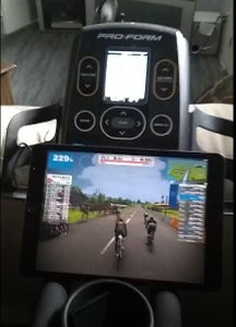

Then I stumbled on a posting by Thomas Schucker regarding his Arduino Zwift Interface for a folding exercise bike. Through his documentation, and largely his code I was able to adapt it to my old TDF bike (Big Thank You Thomas!). Thomas's solution used the magnetic properties of the bike's flywheel to derive cadence and power. My TDF bike has a magnetic resistance motor with integrated position potentiometer and a magnetic pickup for pedal cadence. Between the two I was able to derive bike power (at least matching what the TDF Console said the power was) and cadence. With this I was able to send the data to Zwift via bluetooth on an Arduino Nano BLE microcontroller.
At this juncture, my TDF bike sends power and cadence data to Zwift. I manually monitor the Zwift displayed incline and adjust the bike's incline accordingly. While this is perfectly usable, I hope in the near future to "close the loop" and use the output from Zwift to automatically activate the incline control switches on the bike.
Part of my "requirements" for this project was to have minimal modification to the TDF Bike. That is - I did not want to break it! The bike interface requires tapping into the wiper of the magnet position potentiometer, ground, and the supply side of the magnetic pickup. This does require some disassembly of the bike cowling and soldering into some wires.
Note: As of May 8, 2021 I noticed that the Arduino Nano used in this project is not compatible with computers running Windows 10, that is it will not pair properly with a Windows 10 laptop running Zwift. The work around for this is to use the Android/Apple Zwift companion applications on a smart phone and pair the Arduino Nano to the companion app. Zwift can then be run from the Windows 10 laptop with sensor communication handled by the companion app.
Note: As of December 18, 2021 I changed the Arduino INO program file for the cadence reported to the game to better match the bike display RPM. I also added a variable (RPMPowerFudge) that allows fine tuning of the power value fed to the game to better match the power display of the bike. I found that setting this variable to 0.9 worked well for my particular bike.

Power up the bike and let it boot up and stabilize. Put the bike into "manual mode" and adjust the bike display to show % grade and gear on the bottom window (my preference).
Now connect the RCA cables between the controller and bike, keeping "Power to Power" and "Cadence to Cadence". I have been connecting the bike and controller in this sequence to minimize the chance of "zapping" the controller inputs from power up voltage spikes. I also disconnect the leads from the bike prior to powering it down.
Start up Zwift (or RGT) on your PC/Tablet. Go to the pairing screen and click on Power Source. The Nano 33 BLE should become visible (if not try powering down the controller and restarting it). Select this as your power source. Click on Cadence and also select the Nano 33 BLE.
At this point you should be good to ride. Since there is no feedback from Zwift to the bike I typically monitor the grade displayed by Zwift and manually increase or decrease the bike incline. Speed and cadence are calculated by Zwift. I keep the bike display with the RPM and Watt windows open. I have noticed that the "power calculation" within the Arduino software that sends the power data to Zwift tracks very well with the power displayed on the TDF bike console (I sweated quite a bit figuring out the quadradic equation on that one!). That is not saying the power is correct, just that it agrees with what the bike manufacturer figures the power should be based on resistance and RPM.
