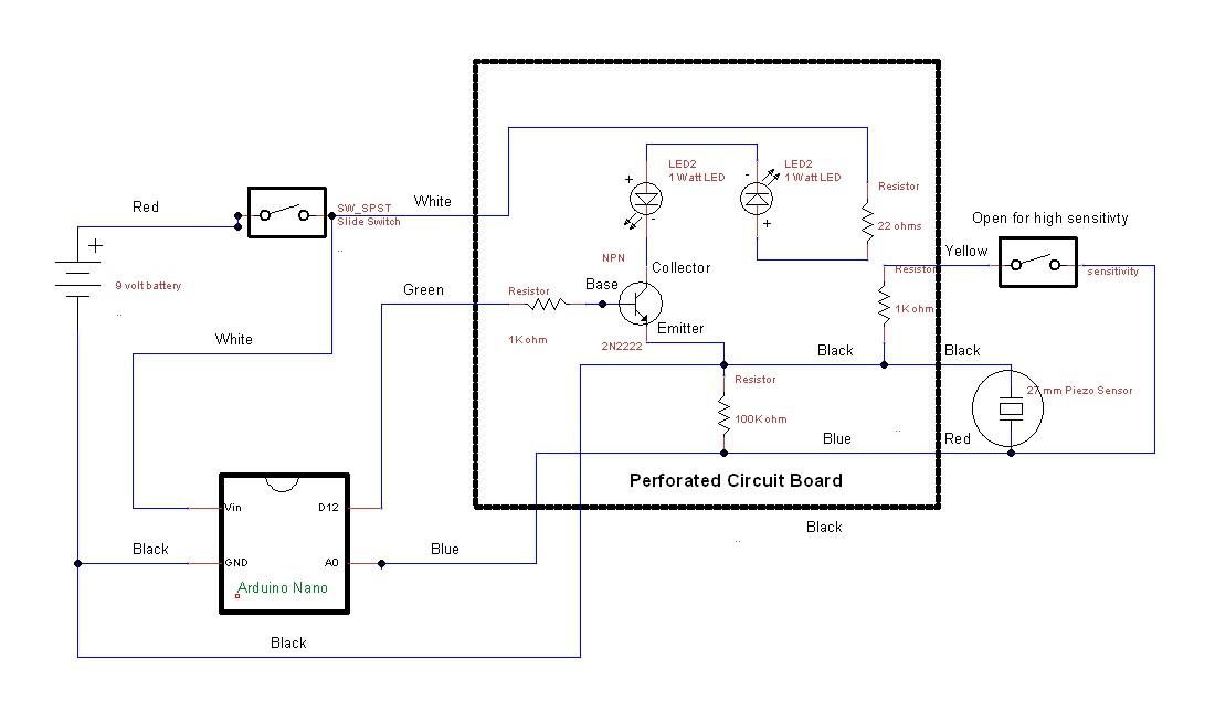

Using the above project as a guide, I modified it to suit our particular requirements. This has included using higher powered LED’s with associated driver circuit and an internal battery check function.

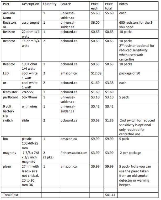

Parts List:
Links to suppliers are below and approximate costs. Some items come in multi-packs where only a single item is required- example the box enclosure (comes in a package of 5) so you may wind up with some left over bits and pieces. To build a single unit should cost approximately $45.00, but due to quantity prices, 5 units may cost around $20 each.
Arduino Nano 1 required from Universal Solder $8.90 each
Resistors (Assortment) from Universal Solder $6.60 for 600
or:
Resistor 22 ohm 1/4 watt 1 required (10 Pack) from pcboard.ca ) $0.63
Resistor 1K ohm 1/4 watt 1 required (10 Pack) from pcboard.ca $0.63
Resistor 100K ohm 1/4 watt 1 required (10 Pack) from pcboard.ca $0.63
LED (2 required) cool white 1 watt 50 pack from amazon.ca $11.29
or
purchase individually from pcboard.ca (2 required) $1.69 x 2= $3.28
Transistor 2N2222 NPN (or equiv) 1 required from pcboard.ca $1.69 each
Perfboard 1 required (5 pack) from Universal Solder $3.50
9 volt battery clip 1 required from Universal Solder $0.42
Slide switch 1 required (or 2 if optional sensitivity switch is installed) from pcboard.ca
Box 1 required (5 pack) from Amazon.ca $9.99
Magnets 1 - (2 pack) required from Princess Auto $3.99
Piezo 1 required (5 pack) from Amazon.ca $9.99 (could be pulled from old smoke detector)
Also- likely available from home workshop or local hardware store:
22-24 gauge wire (preferable stranded, but could be solid). 4 different colors, a foot each. I used white, blue, green and black as described in the schematic. I pulled wire from an old S-video cable or USB cable.
18 inches of ½ inch Velcro – will have some left over.
2 x 6 inch piece of corrugated plastic or cardboard.
2 x 4 inch piece of Aluminum tape.
6 inches 2 way carpet tape
A piece of 2 x 1 inch magnetic tape
Black Electrical tape
Hot melt glue gun and approximately 3 sticks of glue
30 watt or less soldering pencil- NOT a soldering gun!
Rosin core solder (approx. a foot)- NOT acid core plumbing solder.
A piece of closed cell foam 2” x 1” x 3/8”. (Packing foam or piece of pool noodle)

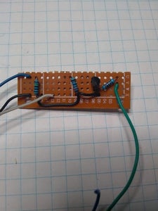

Cut 2 pieces of perforated circuit board- 1 piece 2 inches x 5/8 inch (LED and transistor board) and 1 inch by 5/8 inch (switch board). The easiest way to cut the board is to score both sides with a razor knife, making sure the copper pads are cut through then snapping the board like a piece of drywall. On the 5/8 inch width of the boards, 5 complete hole rows should be intact with the cuts running along the center of the holes of the adjacent rows. Check to ensure the boards fit in the box allowing the lid to close, trim the boards with a razor knife if required. See also https://makezine.com/2015/10/15/how-and-when-to-use-protoboard/

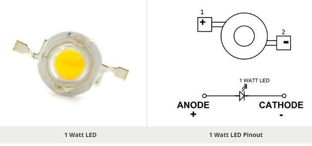

Solder the LED’s on the copper pad side of the circuit board according to the schematic. Note the polarity of the LED pins- there is a tiny + and – on the pins. The – of LED will be connected to the + of the second LED
Step 4: Mounting Remaining Components
Mount the resistors and transistor (see transistor drawing) on the circuit board according to the schematic. Mount these components from the non-copper side of the board so leads can be soldered on the copper side. Also mount 8 inch length of wires as follows:
White- 9 volt power from switch feeding positive side of 22 ohm resistor
Black- ground
Blue- positive side of 100K ohm Resistor to feed positive side of Piezo sensor and input of analog input of Arduino controller.
Green- 1K ohm resistor connected to base of transistor. Open end of wire will connect to digital output of Arduino controller.

Step 8: Solder the Wires to Arduino
Cut a 4 inch length of black wire and solder one end to a gnd connection on the Arduino board (there are two gnd connections on the board, it doesn’t matter which one).
Solder the free end of this black wire to the end of the black wire from the LED board, the black wire from the piezo sensor, and the black wire from the 9 volt battery clip. Wrap this connection in black tape or heat shrink.
Cut a 4 inch length of blue wire and solder this to the A0 connection on the Arduino board.
Solder the free end of this blue wire to the blue wire from the LED board, and also the red wire from the piezo sensor. Wrap this connection in black tape or heat shrink.
Solder the green wire from the LED board to the D12 connection on the Arduino board.
Solder the loose end of the white wire from the switch to the Vin connection on the Arduino board.
Double check all connections, especially the ones on the Arduino board. Ensure the switch in the off position (slider towards the two joined pins, then connect a 9 volt battery to the clip.

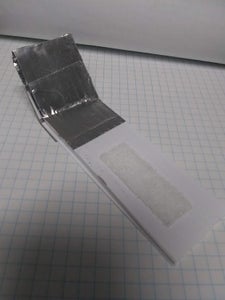

Step 13: Make Reflector
Cut a 1 ¾ x 6 inch piece of corrugated plastic or corrugated cardboard (corrugation running lengthwise). Score one side widthwise 1 ¾ inch from an end with a razor knife and bend at a 45 degree angle. Line the inside of the fold with aluminum foil tape to create and reflective surface extending the foil 1 inch down from the fold. A few layers of foil along with some duct tape on the rear of the coroplastic/cardboard can be used to maintain the 45 degree angle. Finally apply a 2 inch piece of loop Velcro to the coroplastic/cardboard for attaching to the box lid.

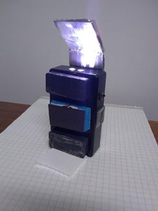

Step 14: Operation
Operation and Use:
The target indicator is turned on with the side switch. The indicator will then go through a startup routine and a battery test. If the battery is above approximately 6 volts, the LEDS will flash once. Once the battery drops below 6 volts, the LEDS will flash 3 times signaling the batteries are about to fail. The LEDS may start to dim before this, and if visibility is impaired the battery may require replacing earlier.
Ensure the target is made of a metal thick and strong enough to prevent bullet passing through and destroying the indicator. Mount the indicator to the rear of the target with the magnets, ensuring the indicator box if fully protected. Position the reflector so it is “peeking” over/around the target at an angle that the LEDS are reflected back towards the shooter. The reflector itself is sacrificial and will need to be replaced over time as it gets shredded by bullets.
The indicator will flash the LED’s when a bullet strike on the target is detected. The length of time the LED’s will flash is set within the program by the variable “notifInterval” currently set at 3000 milliseconds (3 seconds) and can be adjusted as required. If a bullet strike occurs while the LED’s are flashing, the flash interval will be extended by an additional 3 seconds. This behavior is governed by the variable “resetTarget” and is currently set at “1”. If you would prefer to have bullet strikes ignored while the LED’s are flashing, set this variable to “0”.
The sensitivity is set within the program by the variable “threshold” currently set at 500. This is a mid-range value that works well with 22 long rifle ammunition on steel plates at 100 meters. If false hit indications are triggered from the sound of a bullet missing the target or dirt splashes, increase this variable value to a maximum of 1023. This is very likely with centerfire rounds. If value is too high, legitimate impacts may not be detected. If false hit indications are still a problem, a second switch applying a 1K resistor across the existing 100K will further reduce the sensitivity (see schematic).
If used with centerfire rounds, it is recommended to secure the indicator to the target with bungee, strap, or duct tape in addition to the magnets as the impact energy may cause the indicator to fly off the back of the target.
