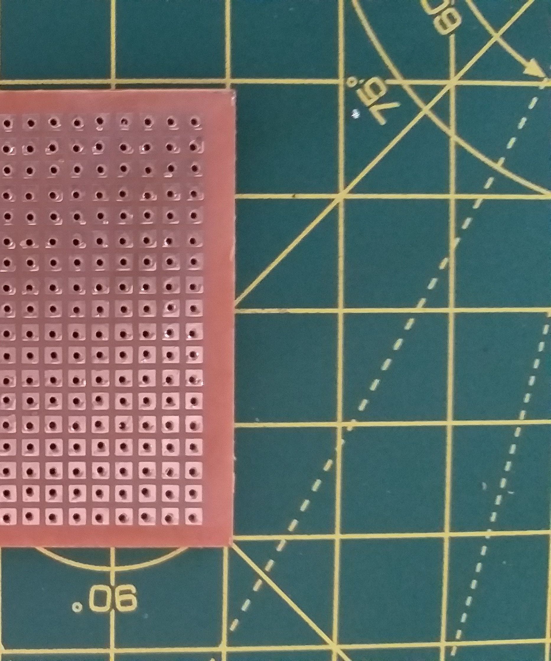

Step 1: Required Parts
1)NodeMCU - 1 ( https://amzn.to/35hyEi0 )
2)2-CH Relay Module- 1 ( https://amzn.to/2ZhZtz7 )
3)IR Sensors - 2 ( https://amzn.to/2ZiLn0f )
4)Connectors -Few ( https://amzn.to/2Fcqddp )
5)Hi-Link 12v or 5v Power Supply - 1 (https://amzn.to/2FcpjNT ) - 5v
6)7805 Voltage Regulator - 1 ( https://amzn.to/3bA5YSK )
7)220uf capacitor - 1
8)22uf capacitor - 1
