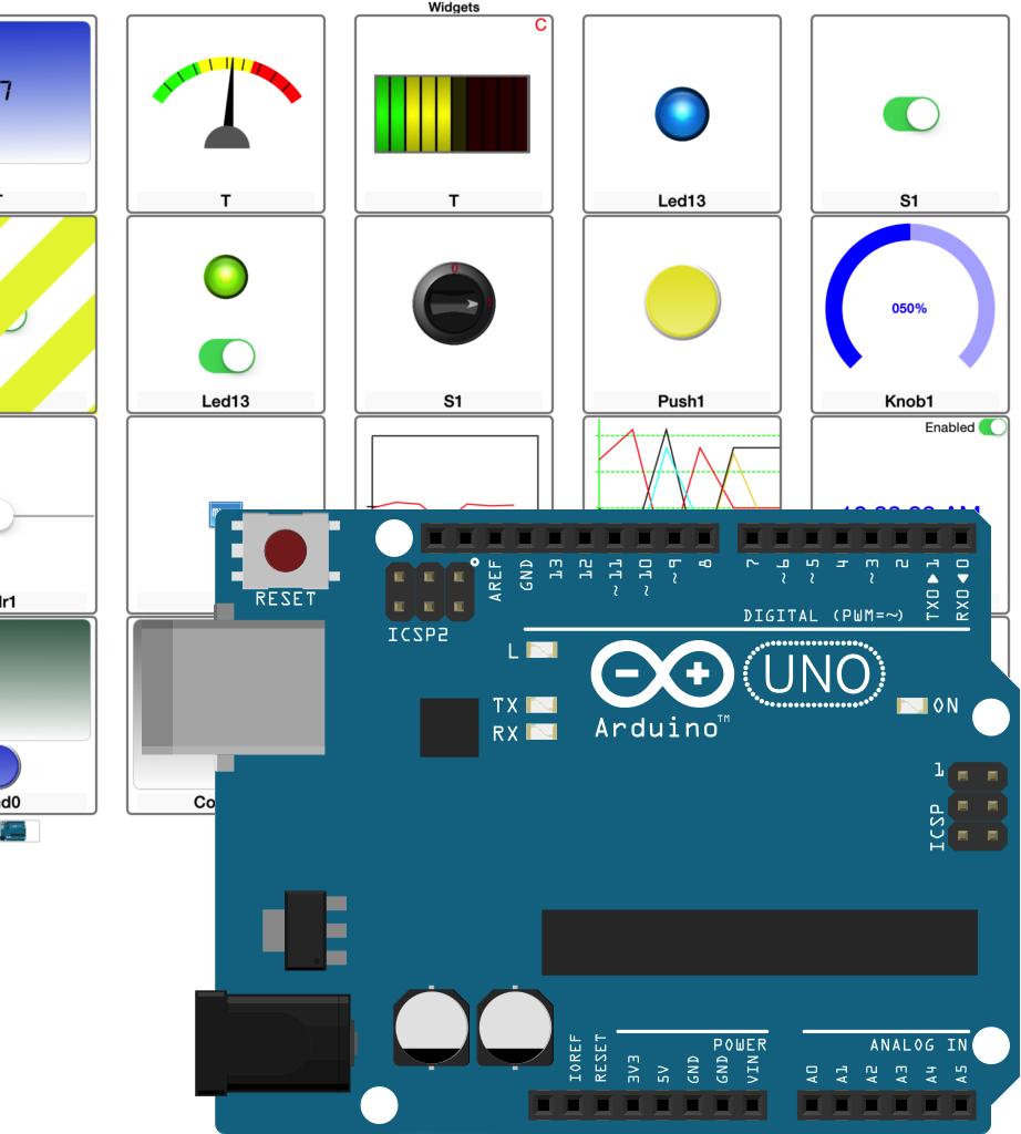

This simple instructable is about Arduino Manager, a powerful general purpose iOS App which allows to control any Arduino (or Arduino compatible) board by the means of about 40 different Widgets.
Some of the available Widgets are:
  • Display Widget
  • LED Widget
  • Switch Widget
  • Push Button Widget
  • Knob Widget
  • Slider Widget
Arduino Manager also provides (at an extra cost):
  • Code Generator: This add-on allows to generate the basic Arduino code for supporting the Widgets you have chosen.
  • PIN Code Generator: Linking widgets to Arduino PINs this add-on dramatically speeds up Arduino code development. In many cases you don't need to write a single line of code.
  • Voice Commands: Enables to control most of the Arduino Manager Widgets by the means of voice commands (English only).
Recently, Arduino Manager for iOS has gained Apple Watch support: you can control any Arduino board directly from your wrist, everywhere in the world.
Arduino Manager for iOS is available here: iTunes Store for $7.99. It is also available for Android and Mac OS X (please, note that not all the widgets are available on all the platforms).
