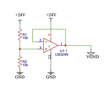

Step 5: Dual Voltage From a Single Voltage
What if the dual voltage is not available? The simplest way to generate the dual voltage is starting with a single voltage and using the shown circuit to make a virtual ground (VGND).
The voltage divider splits the voltage in two and the OpAmp acts as a buffer, keeping it stable and (almost) independent from the current drained.

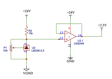

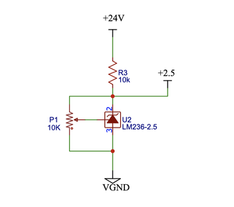

Many chips are available to provide a precise and stable voltage reference. A cheap alternative with a reasonable precision could be the LM236-2.5V (datasheet) (be careful some datasheets report wrong pins' positions).
Even though the chip should provide an exact 2.5V, the output voltage could be different. The shown circuit can be used to trim the voltage at exactly 2.5V.
To make the reference voltage independent from the supplied current, a voltage follower can be added as shown in the second figure.
Using a good multimeter connected between +2.5V and Vgnd, rotate the trimmer until the multimeter shows exactly 2.5 volt.

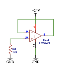

Step 8: Unused Amplifiers
In the circuit, only three out of four available amplifiers are used. To avoid the risk of oscillations and instability, best practice suggests not to leave unused amplifier unconnected. The picture shows how to safely connect the unused amplifier.
