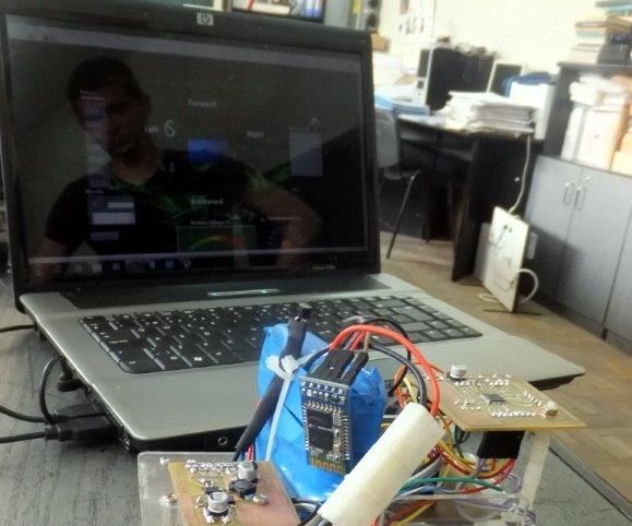

My concept is a montage H bridge using only low side mosfet to control engine speed, and high side mosfet is used only to open and close the circuit. For low side mosfet i use IRF3205 that have very low RDS on and low gate charge. For hig side the use IRF5305, which also rds-on small and low gate charge. To switch low side MOSFET I used driver current 2A, MAX627.
According to the diagram, to rotate the electric motor in a sense we need to apply the command on to the point A (5V from ATMEGA328) and low side MOSFET diagonally ordering the PWM duty cycle between 0 and 100% . Variation of duty cycle will vary the speed of rotation. Meanwhile other MOSFET will be placed in logical 0 by the controller.
To avoid skin effect due to motor windings maximum PWM frequency is 10KHz.
This assembly was tested with an engine that had a rated current of 4A and transistors temperature no more than 30 degrees. Additionally you can put the radiator, but the current does not exceed 5A do not think is appropriate.

H bridge is controlled by an Arduino module designed by me with a ATMEGA328 smd.
I have upload this code to this step.
Step 3: LabVIEW VI
This is my VI for this project, I upload it to this step. I created in LabVIEW 2013.
