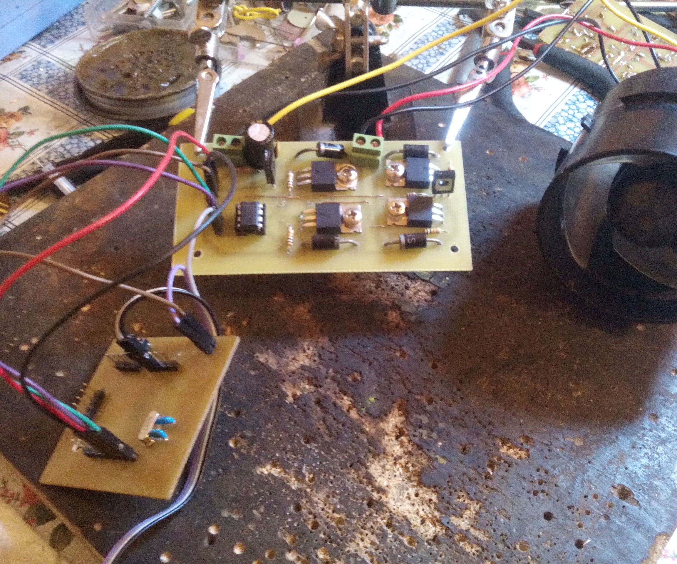

Step 4: Driver Motor Board
The power module for control two DC motors is carried out with the L293D, the chip is capable of a maximum current of 600mA. This is an integrated circuit for controlling continuous two H bridges two different engines have integrated and enable speed control function.
Step 5: Power Supply Board
This module is a high efficiency buck converter to reduce the voltage to 16V (laptop battery) required 5V logic supply all parts of the chassis. It is designed with integrated circuit MAX5035B and is capable of a current of about 1A. The module is built with SMD components.
