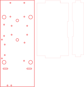

Step 1: Creating the Robot Chassis
Designing
To hold the components that you have, you need to create a chassis. I created the box using adobe illustrator, which I found the easiest. Once completing it, I imported the design into fusion to verify if all the parts fit together properly. To start off, it is best to think about what your robot is going to look like, and make simple shapes in adobe. Add some detail, and once you are finished with the layout we now have to add grooves. These can be added either by using https://en.makercase.com/#/ or by creating it yourself! Make sure all the grooves align and fit by importing the adobe file into fusion. It helps to design a board where you can mount your components easily, allowing for easy, clean, and neat configuration within your robot.
Cutting
To cut your design, you will need a laser cutter. I would personally recommend MDF since it was the easiest to work with, but other types of wood will also work. Once your parts are cut out, simply use wood glue to secure all the sides together, except for the top since the interior still has to be accessed.
