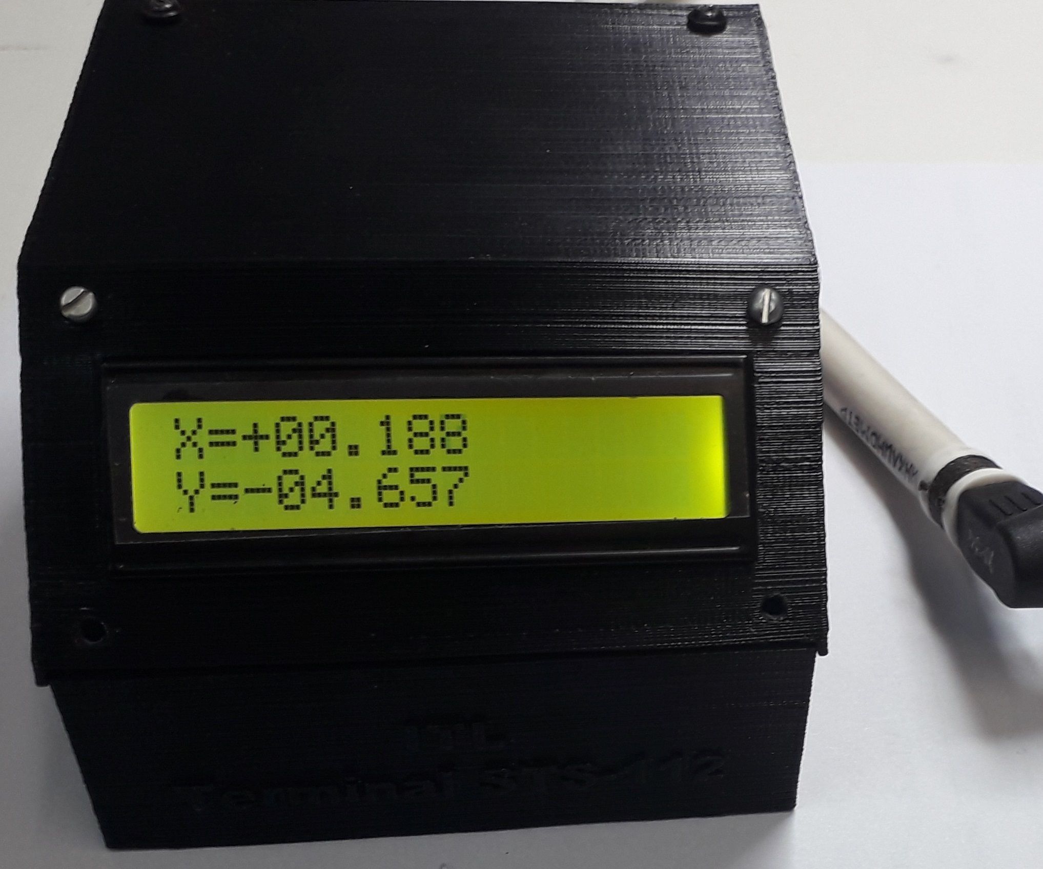

It so happened that we got two attenuators Agilent 8494H and 8496H. They were lying idle for a long time, because there was no control controller. Of course, four simple switches would cope with this task, but I wanted an implementation with a display showing the current attenuation value and software control. The project was made in Altium Designer and Atmel Studio.

The controller is built on the Atmega328-AU placed on a double-sided printed circuit board. The circuit is powered from the USB port (5 V). To switch the solenoids in the attenuator, a voltage of 24 V is required, which is obtained from the DC-DC step-up circuit (5 V - 24 V). This voltage is supplied for a very short time, about 50 ms.
The encoder is used to increase and decrease the attenuation, the encoder button is used to select the attenuator.

Step 5: Appearance
