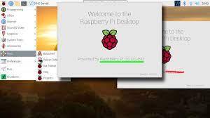

Step 1: Setting Up the Raspberry Pi
Use this link here for easy guide for setting up the microcontroller or watch the video.
