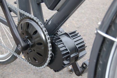

Step 15: Attach the BBSHD to Your Bike
We now have a battery but we need something for it to power. Let's attach the motor to the frame.
Slide the motor through the bottom bracket, add the included bracing, and tighten up the securing nut and lock ring.
The BBSHD doesn't come with the tool to fit the nuts and I highly recommend that you buy one. They are relatively inexpensive and will enable you to securely fit the motor.
I recommend fitting the chain at this point to check your chainline. With my build I could immediately see that the chain was too far out, meaning that I would not have the use of the largest rear cog. To counter this I took 2mm off the bottom bracket with an angle grinder and used a front derailleur mech as a chain guide.
