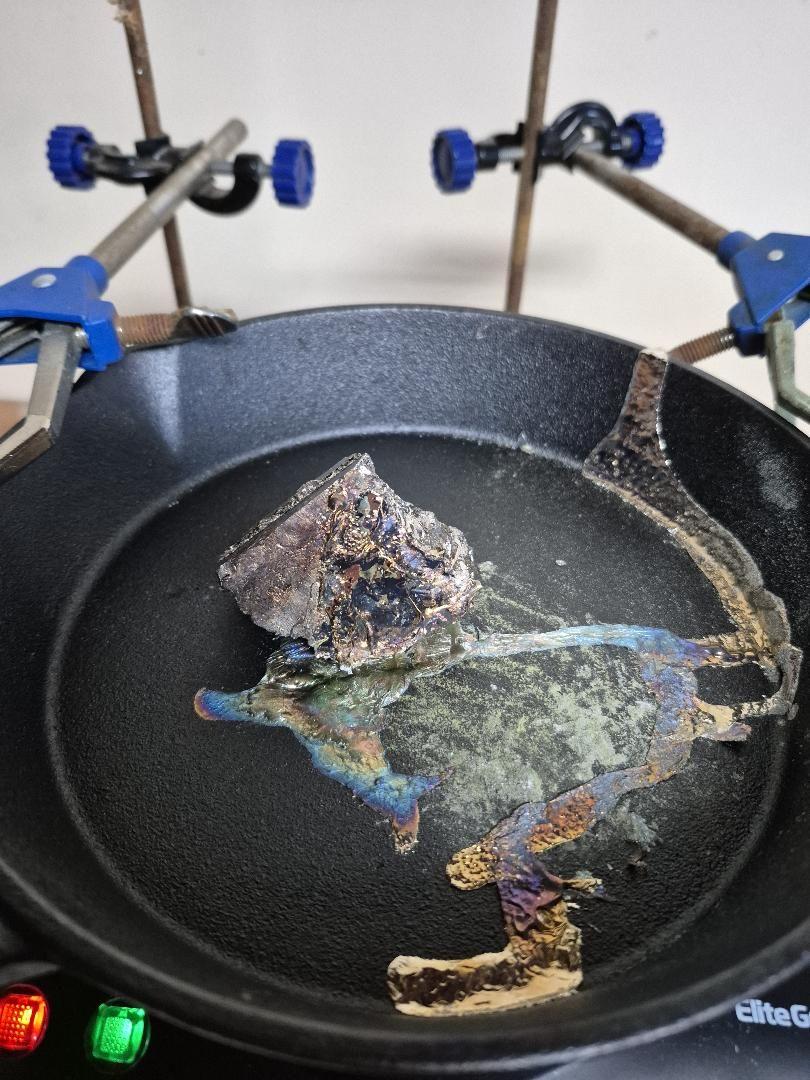

Step 1: Attempts With Bismuth Molds With Muffin Trays
I heated up some chunks of bismuth in those muffin trays and used tongs and clamps to hold them in place on the hotplate. Stir with a tong or popsicle stick with gloves on until the bismuth turns into a liquid. Stir to achieve the proper crystal formation and remove the clamps, etc. Using gloves, carefully pour the molten metal into a porcelain dish within 1 minute.
This method will generate random molds, but it is a tricky method. Be Aware that you have a limited time 1-2 minutes, to pour the molten metal into the porcelain ceramic dish. This is dangerous since we are dealing with molten metal and possibly some fumes. Please always work in a well-ventilated area when handling bismuth metal.

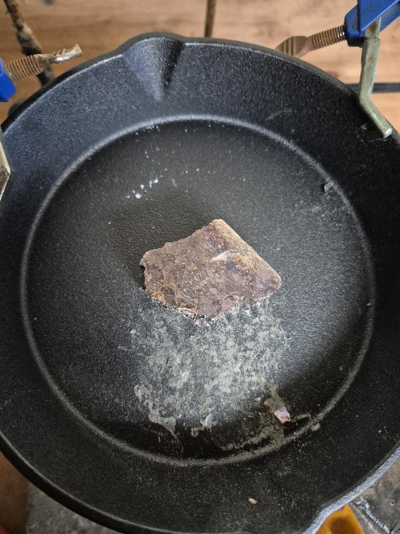

Step 2: Pan Method of Melting Bismuth.
With a hotplate and a thick pan 1 cm thick cast iron heat up the block of bismuth up to 272 degrees C. This will eventually cause the bismuth to melt in the pan. Use a popsicle stick with gloves to stir the hot metal. Remember, you only have a few minutes before the bismuth solidifies again, so do it quickly. Yes, this will more likely ruin the pan.

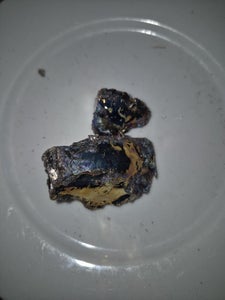

The pan with a hotplate and gloves should take 5 to 7 minutes to reach 271 degrees C with the pan. This is still a very hot metal. Be aware, and then pour the bismuth into the ceramic porcelain dish. It should fizz a bit as it reaches a colder temperature, 20 degrees C, and solidify. Once solid, gently tap it (Warning: It will be very hot, though.)
It can be redone for better results, but impurities like air reacting with bismuth metal will occur.
Bismuth + air + temperatures between 273 degrees C to 300 degrees C>>>> Bismuth oxides.
You can remove the metal (Bismuth crystals) with gloves and put it on a ceramic plate type ((It should not crack even at 272 deg C.) I tried this many times, and it was alright at these temperatures, even the cheaper stuff.
