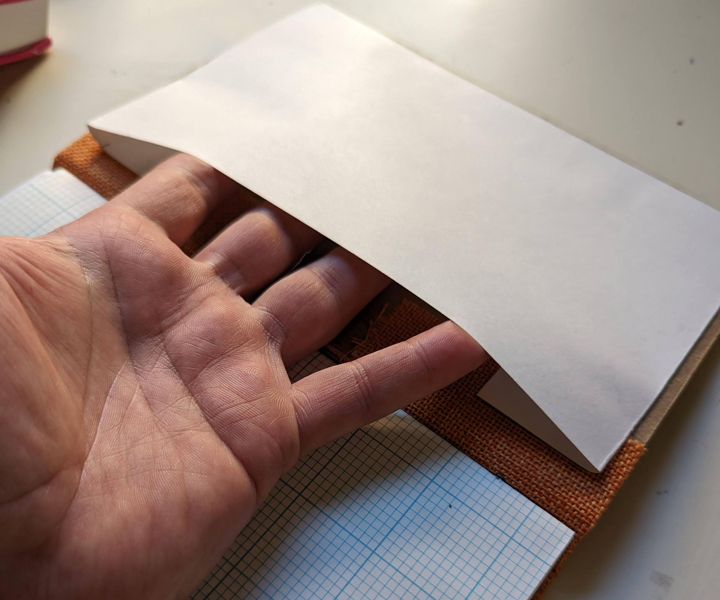

Introduction: Coptic Book Binding
How to begin your coptic binding on a mini-book.
Two cover panels - heavy chip board or similar, equal in size (here, 2"x3")
Linen thread - height of book x number of signatures + 2 (here, 24")
Signatures - however many you want, 4 minimum. Signatures should be cut/ripped slightly smaller (~1/16") than your cover boards.
You will also need a needle and an awl.
