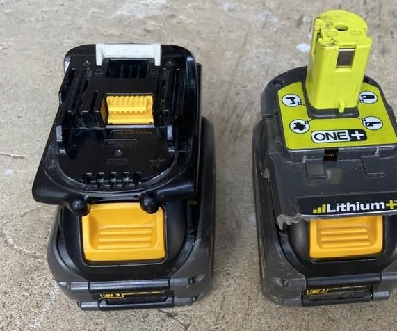

Upgraded battery pack from cheap 1800mAh Lion pack to allow 4000mAh Makita battery packs
Now I can do the whole property on one charge.
Used the semi useless torch as an adapter
Wired though cable from the faulty battery to the contacts for the Makita battery
Simple but effective

Got a box of Dewalt batteries and managed to make 6 good packs out of them
Used the red cap at the adapter plate and added battery connection
As the Dewalt battery packs have no mosfet to disconnect battery internally any power supply set to 21v will charge them. . Generally I set current limit to 2amps
