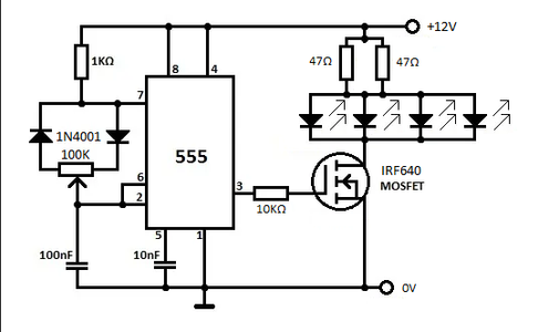

Finally I wished to have some ability to control the lamps brightness, so as to have higher brightness when more light is required and lower brightness for relaxation. To accomplish this I researched on google with the terms 'LED Dimmer Circuit' and 'NE555 PWM Circuit' for any suitable circuits that could be used to control the luminosity of the LEDs. I found a suitable circuit labelled 'A Simple 555 PWM Circuit with Motor Example' on Build Electronic Circuits website (https://www.build-electronic-circuits.com/555-pwm-circuit/) which used a NE555 Timer Chip and I could convert to control the Brightness of my LEDs Brightness.

Components Required for Circuit Board
  • 2x 47Ω 5W Resistors.
  • 1x 1KΩ Resistor.
  • 1x 100KΩ Potentiometer.
  • 1x 12V Processor Fan
  • 1x NE555N Chip.
  • 1x 8PIN DIL (DIL = Dual In Line) Socket.
  • 1x IRF640 N-Channel MOSFET (Metal Oxide Semiconductor Field Effect Transistor).
  • 2x 1N4006 Diodes.
  • 1x 10nF & 100nF Capacitors.
  • 4x 20mm M3 Male-Female Threaded Hex Spacers.
  • 4x M3 12mm Screws + 4x M3 Nuts.
  • 15 AWG Electrical Wire. (Colours as shown in photos).
  • 5mm Pitch Male / Female Pluggable Terminal Blocks.
  • Vero/Strip board.
  • 0.5mm Solder Wire.
  • 12V HJC HASU05F AC Adapter

Step 8: Creation of PWM Light Dimmer Module
A) For the Light Dimmer controller, I found a suitable circuit labelled 'A Simple 555 PWM Circuit with Motor Example' on Build Electronic Circuits website which used a NE555 Timer Chip and I added a IRF640 N-Channel MOSFET (as shown in schematic above). I made further modifications to the circuit to incorporate the four LEDs at the base of the corner lamp.
B) I soldered the components onto some Vero Board (as shown in photos) and bodged the board into a small discarded case I found. I then tested the circuit, tried different resistor values and choose 10k between pin 3 and Gate of MOSFET, 47Ω in series with the four LEDs and a 100KΩ Potentiometer for controlling LED Brightness. When running the LEDs at their brightest I found the 47Ω resistors were getting to hot so found an old PC fan and bodged that onto the top of the case with four 20mm pillars.
C) I have been using the Corner Lamp for the last 6 months and it has functioned well with no problems. I finished the corner lamp by vanishing it with Linseed Oil.
