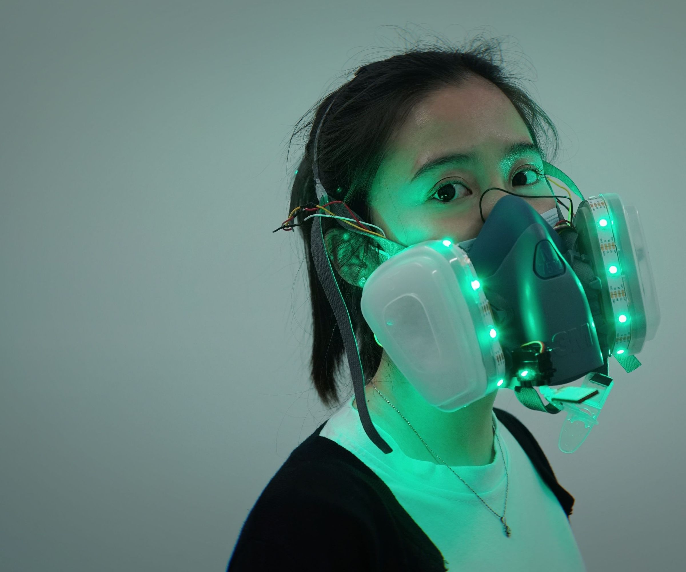

There are two detectors on the mask. Each dectector is made by the same infrared temperature sensor. And I choose to use Grove - OLED Display 1.12'' V2 to display the temperature data on the mask.
This mask has the following functions: Digital infrared temperature sensor above the mask can detect the self-body temperature in real time and show up the temperature on OLED display that is attached on the mask. The detector on the other side can detect the temperature of the person I have contacted. If the other person's temperature is normal, the RGB LED ring in the left eye part is green. If the other person ’s temperature exceeds 38℃, the RGB LED ring will turn to red color and be accompanied by an alert, indicating that he/she is a potential risk with coronavirus , then I will advise him to go to the hospital for test and treatment.
