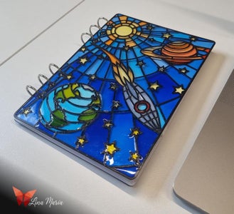

I wanted to create a beautiful and functional folder to organize and display my cut dies — something that would work as both a storage binder and a little showcase of the shapes they can cut.
The idea was to alternate blank sheets, where I could glue samples of each die cut, with transparent plastic pockets to keep the actual dies safe and easy to find.
But of course, I didn’t want an ordinary binder — I wanted one that would reflect my love for creativity and color. So I designed a space-themed cover, filled with cosmic shapes, planets, and stars, to make my organizer truly one of a kind.

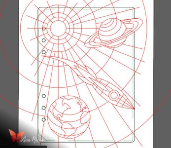

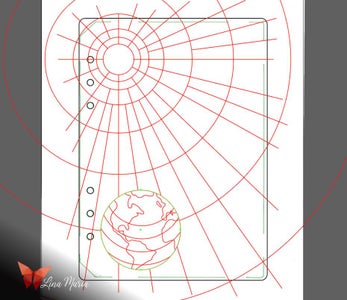

Step 2: Preparing the Digital Template
Next, I scanned the page and opened it in Adobe Illustrator.
I locked the scanned layer to keep it from moving and created a new layer on top.
There, I drew a rectangle slightly larger than the pocket — so the cover and back would extend just a bit beyond the inner pages — and marked the exact spots for the binder rings.

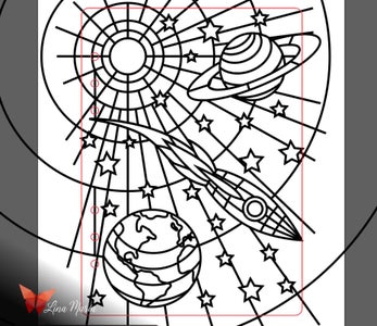

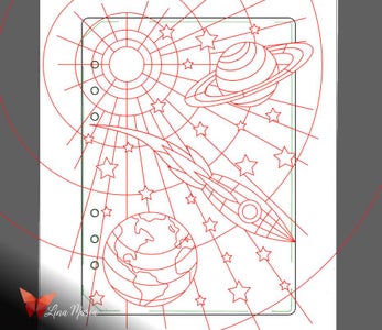

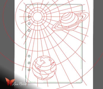

Step 3: Drawing the Design
Now came the fun part — designing!
I started with the Sun, sketching its rays to divide the surface into many colorful sections. Then I added Earth, Saturn, a rocket, and several stars.
Each element created small subdivisions that I would later fill with resin, giving it a look similar to cosmic stained glass.

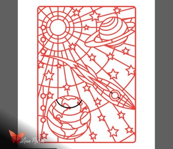

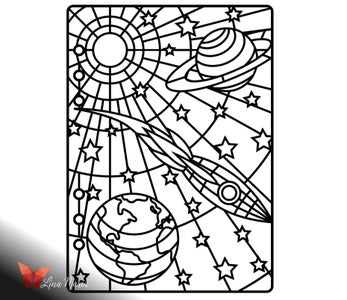

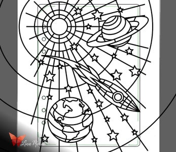

Step 4: Cleaning and Merging the Shapes
When I was happy with the illustration, I set the line thickness to 4pt, then selected Object → Expand.
Next, I used the Pathfinder to merge all shapes of the same color.
All the black outlines became one single piece, and I deleted the leftover white areas.

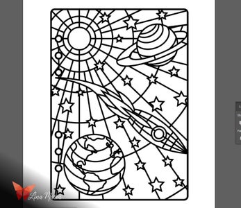

Step 5: Cleaning and Finalizing the Shape
I right-clicked and chose Ungroup to check for any loose parts.
I moved the big figure, and when I noticed disconnected pieces, I went back and added small connectors to link them.
After ensuring everything was one solid design, I saved the file as an SVG.

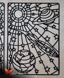

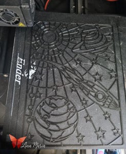

Step 8: Printing the Covers
Both the front and back covers were printed.
Step 9: Preparing the Surface
I covered a section of a wooden board with wide clear tape — this would prevent the resin from sticking permanently and keep the back surface smooth.
Step 10: Gluing the 3D Prints
Using a brush, I applied white glue on the back of the printed covers and pressed them gently onto the taped area.
Then I let them dry completely.

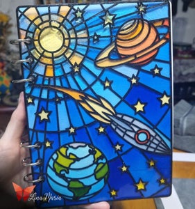

Step 11: Mixing the Resin
Once dry, I prepared equal parts of two-component resin using syringes to ensure precision.
I added a few drops of colorants until I got the tones I wanted — yellow, deep space blues, fiery oranges...
Step 12: Coloring the Sections
With a small mixing stick, I applied tiny drops of each color into the separated sections of the design, watching the colors spread beautifully.

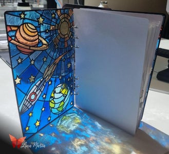

Step 13: Demolding
After letting the resin cure for about 24 hours, I carefully peeled the pieces off the taped board.
They came out shiny, colorful, and perfectly smooth!
Then I added the binder rings, inserted my sheets and transparent pockets.
Step 14: Ready to Use It
Now I have a functional and truly unique organizer for my cut dies, one that inspires me every time I open it.
