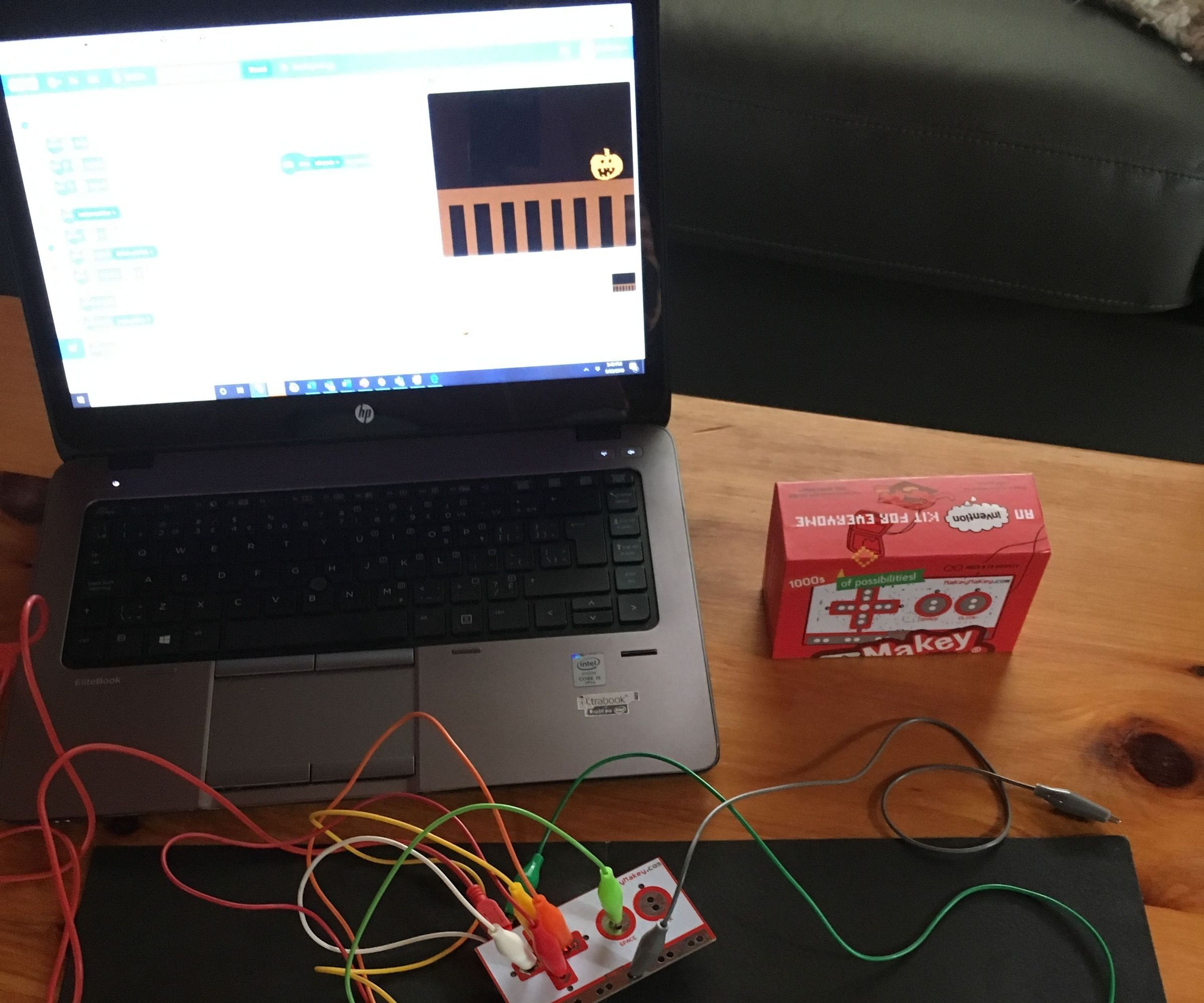

Use this Counting Change Scratch program (image #1 and #2) and connect the Makey Makey. This little program could be remixed by adding more denominations or by adding a way to make change for a purchase.
Connecting the Makey Makey (image #3):
  • red USB cable to the computer
  • space bar alligator clip to a space bar image (image #4)f
    • I made a Scratch space bar by cutting out an image, being sure to leave a tab at the top
    • I covered the tab with aluminuum foil, made a foil strip down the back,
    • and cut out a "space bar" place covered with aluminum foil
  • up arrow alligator clip to the toonie
  • down arrow alligator clip to the loonie
  • right arrow alligator clip to the quarter
  • left arrow alligator clip to the dime
  • w (from the back of the board) to the nickel
  • a (from the back of the board) to the penny
    • I used a jumper cable (image #5) to connect w and a to the alligator clip
  • one more alligator clip from ground for the student to hold while making change
