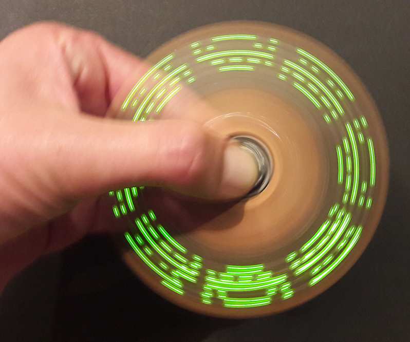

Introduction: Creating POV Sequences.
This instructable will focus on creating sequences that can be used to send to a LED interface.
For programming the template we've used NodeBox 3, an application that focuses on generative design and datavizualisation but is in fact a multipurpose toolkit that can be used in other contexts too. NodeBox is a free, open source functional programming language which comes with a modular interface. For more information on the software, go to their documentation files or download it.

Now we have a basic template which we can use to create other images. Changing the ellipse to another shape creates a new array. You can create a single character of an alphabet. etc.
Step 3: The Template Can Handle Any Path.
complexity.
NodeBox allows to create more complex shapes like funny characters and invaders.
