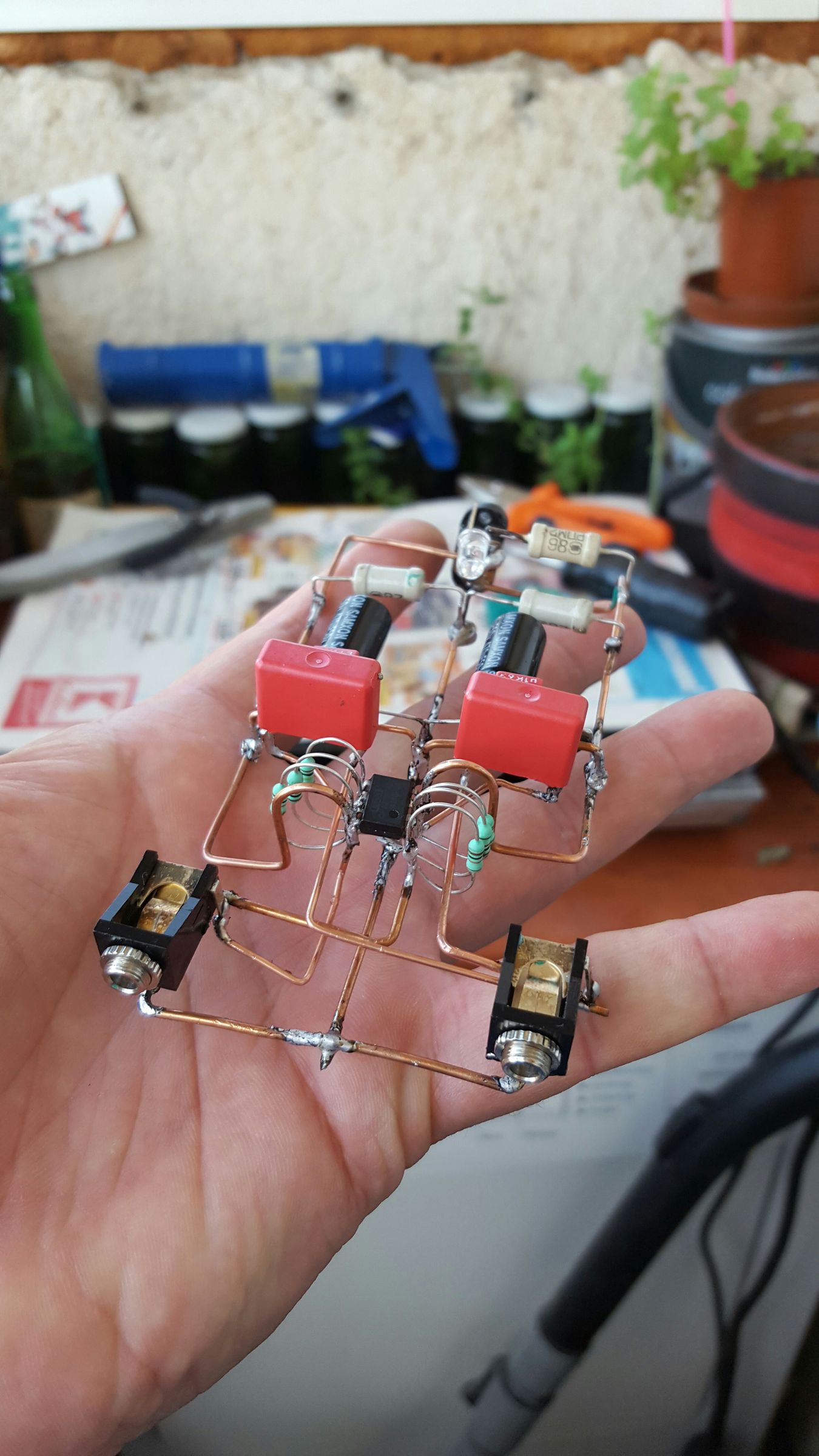

Step 2: Making the Skeleton
This part is very fiddly !
It will test your bending and soldering skills
Everything has to be visually spot on because everything will be on show for all time when its cast in resin.

Step 6: Making the Skeleton 2

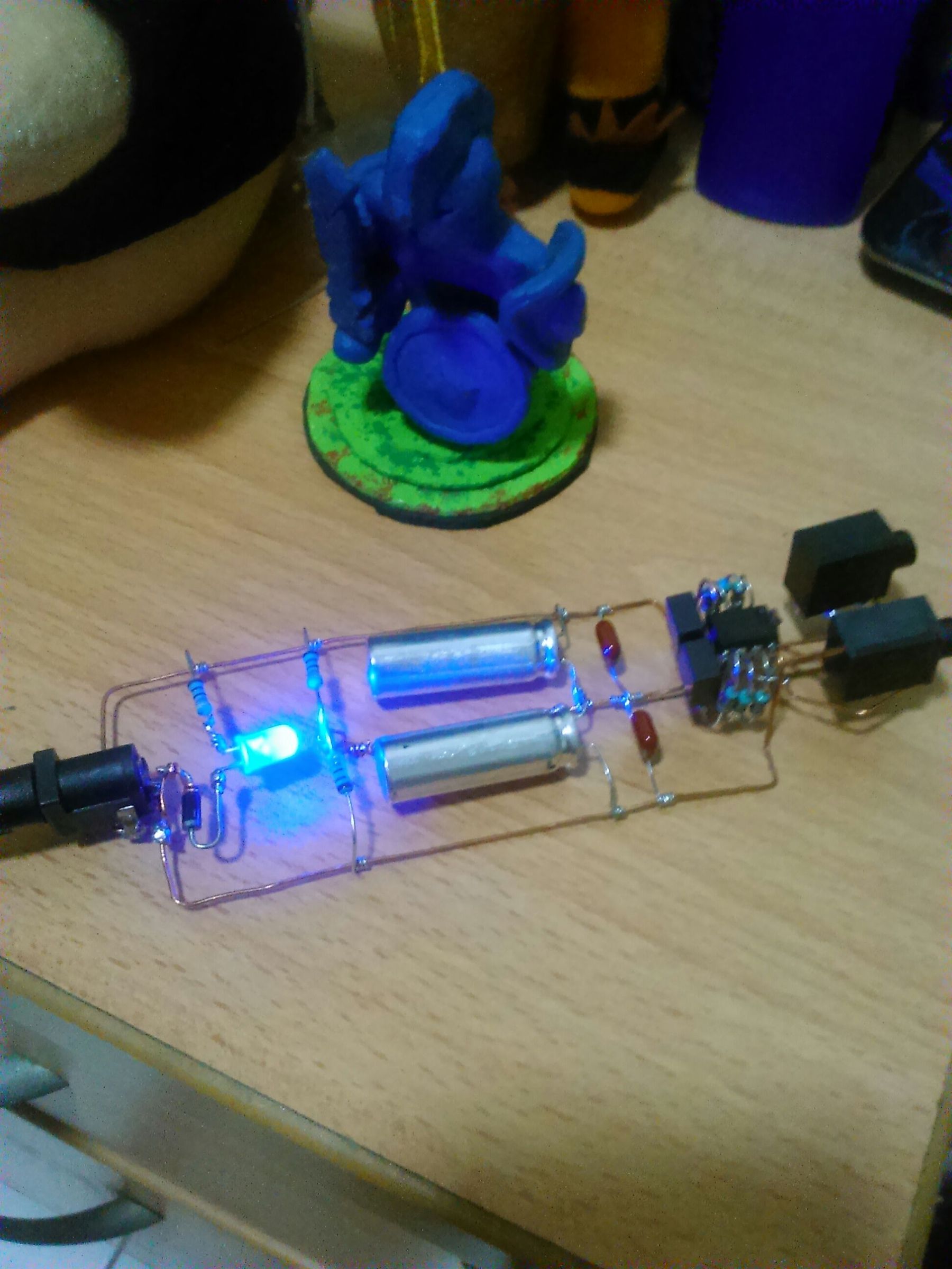

Here we can see the basic layout of the power supply section
It is a double-ended power supply that takes a single-ended input (12VDC) and splits it with a voltage divider.
The hoops on the right are for the op-amp circuit this requires +/GND/- instead of just +/GND.
What this basically means is the power input for the Burr Brown OPA2107 Operational amplifier  or Op-Amp needs -Volts and +Volts the T shaped wire which runs down the middle is the ground or in this case a "virtual ground" produced by the voltage divider it never comes into direct contact with the main power ground incoming from the power jack.
The two 4.7k resistors near the back are the voltage dividers,the supply to the power jack in this case is 12VDC is then halved by the voltage divider producing -6v and +6v on both of the outer copper wires or you could call then buses.
The +V for the LED is fed straight out of the back of the power jack and uses the -6v copper wire for Ground through a 1k Resistor ,as this all comes before the voltage divider as far as the LED is concerned -6v is normal ground.
Now to start adding the other resistors as per the schematic.
Step 7: Making the Skeleton 3

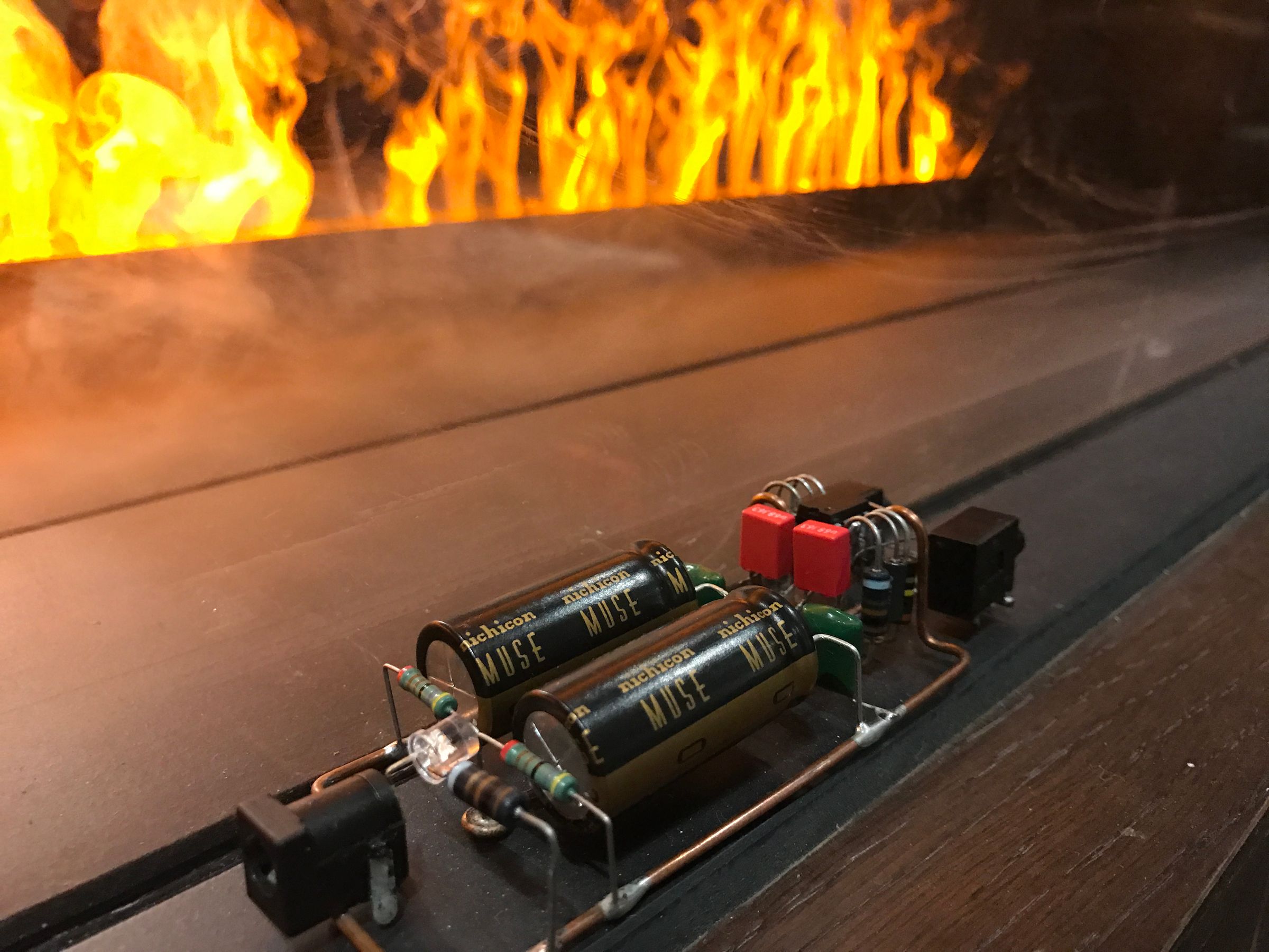

The two large silver 470uf 50v capacitors are for the power supply rails followed by the two red bi-pass capacitors for Op-Amp stability just in case of any oscillation which strictly speaking should be attach as close to the Op-Amp legs as possible .Having said that i haven't had any stability issues with this IC in other Cmoys i have made.
Be careful to check  the polarity of the capacitors before soldering
Step 8: Making the Skeleton 4

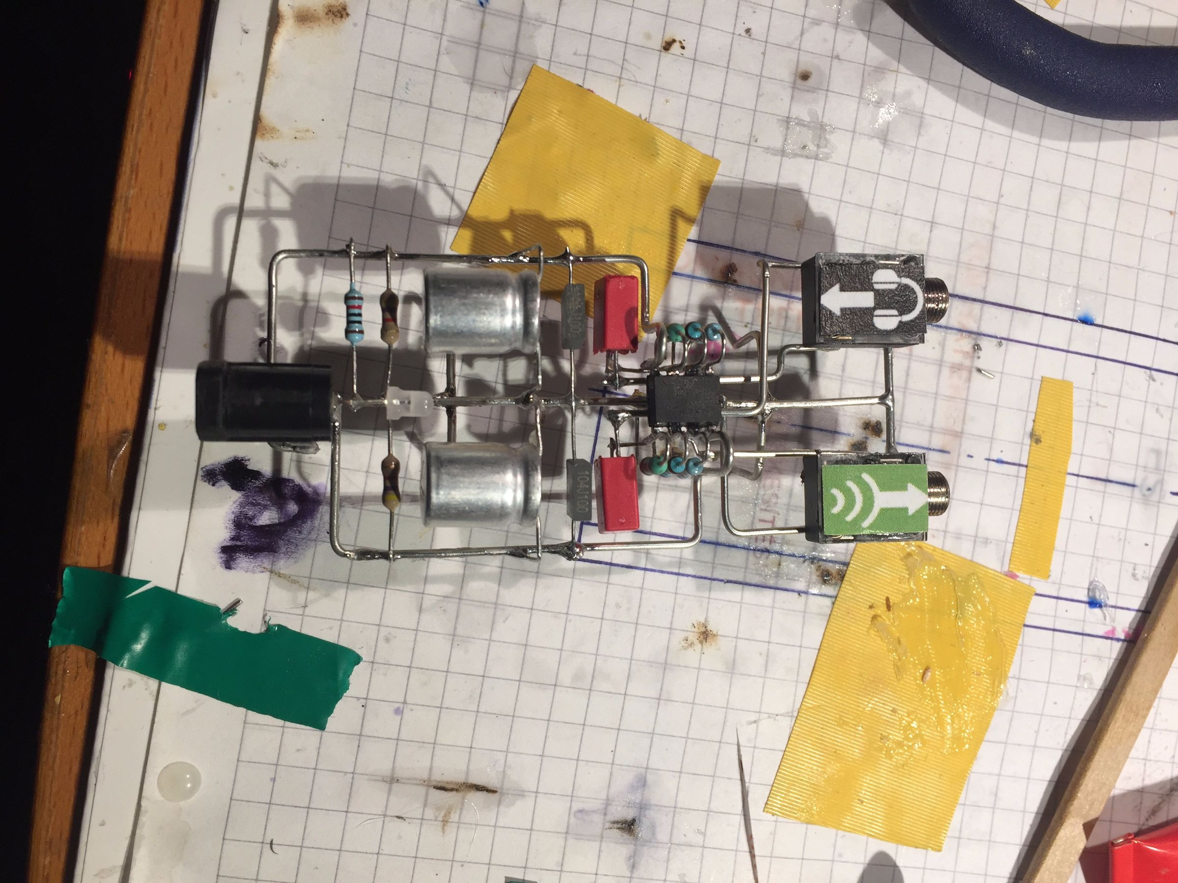

Here you can see the the  Turquoise Resistor legs (R4) sticking out from the top of the Op-Amp IC this is where they loop round from the output to where R5 should be on the Schematic.R5 is optional and i never install it but it still needs to be connected to the output with or with out the resistor this also cuts down on additional wires.The turquoise resistor (R4) sets the gain along with R3.
you can see the loops better in the second picture
In the 3rd picture the bottom 4 Leads can now be connected to the virtual ground (middle copper wire)
Step 9: Making the Skeleton 4
Time to add the Input caps these stop any DC voltage (Direct Current) entering the amplifier from the source (iPod ETC) through the input jack socket as this would also be amplified by a factor of the gain. Audio signals work on AC (Alternating Current).The gain is set quite lower as the input source in this case the PC has high output and there will be no volume potentiometer to physically adjust volume.
In the second picture the legs from the turquoise resistors are bent to form the output connection which will be hooked up to the headphone jack socket.
The 3rd & 4th picture shows  hooking up the audio Input and headphone jacks.
I used enamelled wire from an old transformer to give a consistent look but it also has a good amount of insulation against shorts.
