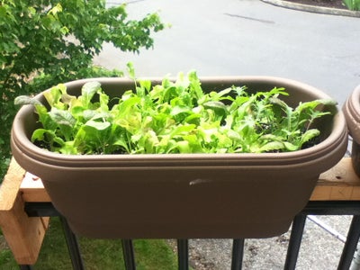

I got some planters to grow a few things on my small balcony. These ones looked suitable because they hang off railings, so they wouldn't take up any of the limited floor space.

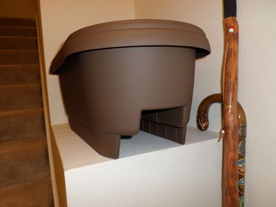

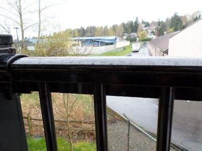

I bought a pair. Lo and behold, their design requires a 2x4 type railing. My railing has a smaller, curved profile. These planters would fall off without some sort of adapter.
I wasn't quite sure how to solve this, but figured the first step was to take a reasonably accurate profile of the existing railing.
My place is a rental, so any sort of destructive modification is out of the question. I cannot saw, drill, braze or otherwise modify the railing itself.

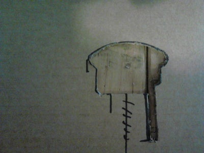

Step 1: Use a Contour Guage to Transfer the Railing Profile to a Cardboard Template.
I asked "How do I take a contour off my balcony railing and transfer it to a piece of wood?" in this discussion.
wilgubeast suggested I use a contour guage, so that's what I did. Got a decent one for $4 + tax at Harbor Freight Tools. I got my money's worth out of it on this project and I am sure it will be handy in future.
I transferred the contour to a piece of cardboard and cut out a template for "wings", as suggested by caitlinsdad.
