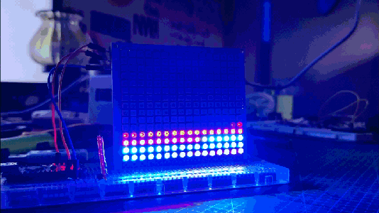

Introduction: Custom 16x16 WS2812 Mini Matrix Project
About: Hello world;
Hey what's up you guys?
So here's another Matrix Project made by using an unusual RGB LED Part, WS2812B 3535 Package.
256 RGB LEDs are arranged in a 16x16 grid, WS2812 Addressable LEDs were used so no LED Driver or complex multiplexing circuit has been added to this board.
As for the Layout, all the LEDs are laid out in an OXPLOW layout, OXPLOW is a matrix type in which LEDs go one way in one row, and then backward in the next row, and so on, this layout is also called boustrophedon.
There's also another layout which is the serpentine Layout and LEDs in this layout are laid out in a continuous chain like a snake thus the name serpentine.
This Matrix can be controlled by both Adafruit Neopixel Library and FastLED Library or a similar matrix library.

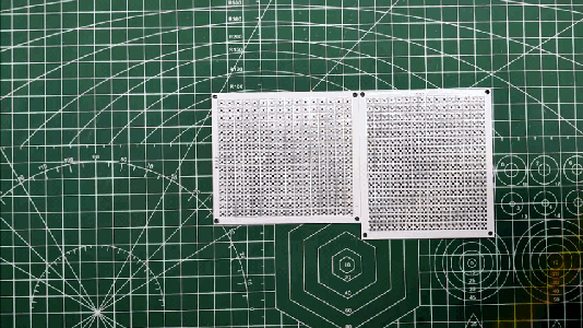

After completing the PCB Design, I exported the Gerber data and send it to ELECROW for samples.
For this order, White Soldermask with black silkscreen was chosen, 1.5mm Board thickness with 1 oz copper.

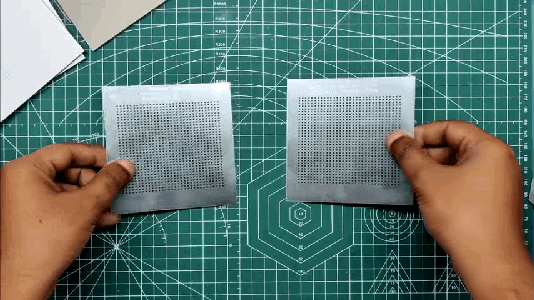

Also, because this matrix has 256 LEDs, it was super hard if we manually add solder paste to each component pad which in this case would be 1024 as each led has four pads.
We ordered a stencil for applying solder paste and making the soldering process easy.
PCB Service from Elecrow was Super Awesome
ELecrow provides various professional services, including PCB manufacturing,PCB assembly, and 3D printing service. The PCB manufacturing price is as low as $1. Besides, the packaging was pretty decent, and it took a week for delivery which was super fast.
Check out Elecrow for getting great PCB services for less cost.

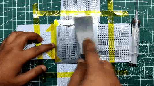

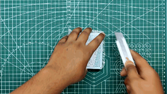

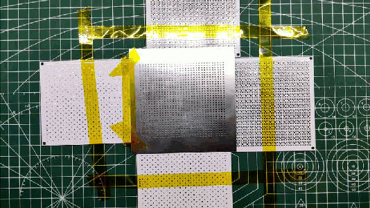

Step 5: Solderpaste Dispensing With Stencil
We first apply solder paste to the board.
I usually use a dispensing syringe for this process, but this matrix contains 256 LEDs each with four pads, so 1024 pads require solderpaste.
Instead of manually applying solder paste to each component pad, we use STENCIL.

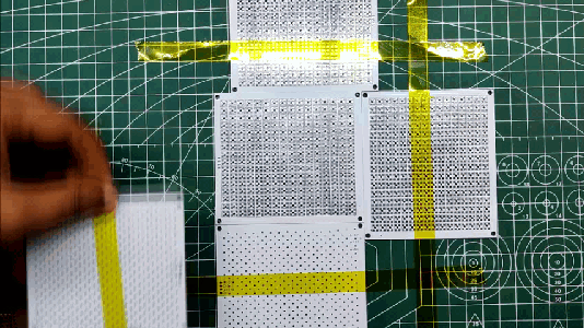

STENCIL
A stencil is a Metal Sheet with Cuts and slots made according to the soldermask layer of the PCB, goal of the stencil is to apply solderpaste on the PCB through the cuts and slots.
  • As for applying the stencil, we first place the main PCB in the same view as it was in the PCB Design.
  • We add three PCBs to hold the Main PCB in middle by sticking all the PCBs with tape so they won't move and keep Main PCB in its place.
  • Next, we add the fourth PCB and on top of the fourth PCB, we add a stencil.
  • we slide the stencil on top of the main PCB to match the pads of components and then add tape to hold the stencil in its place.
  • Next, we add solder paste to both sides of the stencil and then use a scraping tool to apply solder paste to each slot. solderpaste will fill the slots and get added to component pads.

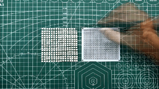

Step 6: Pick and Place
Next, we gather 256 LEDs and get ready for the Pick and place process.
  • To get this step right the first time, we arrange LEDs in a grid of 16x16.
  • We pick each LED by using an ESD Tweezer and place them on their pad in the right alignment.
  • We do this process for 256 LEDs and then check their alignment before moving to the next step which is the Hotplate Reflow Process.

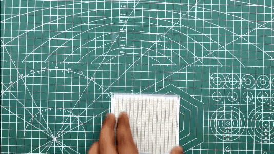

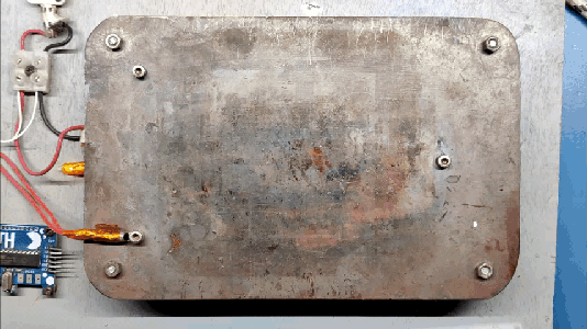

Step 7: Hotplate Reflow Process
After the "Pick & Place Process", I carefully lifted the whole circuit board and place it on my DIY SMT Hotplate.
the hotplate heats the PCB from below up to the solder paste melting temp, as soon as the PCB reaches that temp, the solder paste melts and all the components get soldered to their pads, we lift the PCB and then place it on a cooler surface for a little bit, to cool down the heat of PCB.

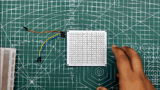

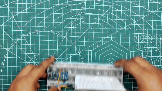

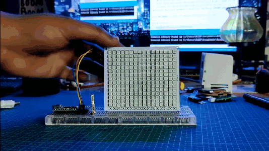

Step 8: Arduino Setup
To Drive the Matrix board, we need to connect an Arduino Nano to the matrix by following the above wiring Diagram.
  • VCC of Matrix will get connected to 5V of Nano
  • GND to GND
  • Din of Matrix to D3 (any PWM Pin)
We Solder Jumper Wires directly with VCC, Din, and GND pins of Matrix so we can connect Matrix with Arduino Nano through a breadboard.

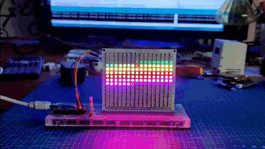

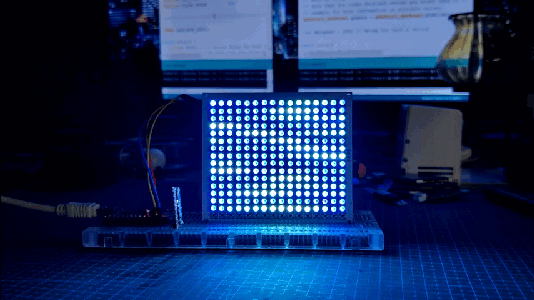

Step 10: LED TESTING
For the first test, we will be utilizing Adafruit Neopixel Library, we open Adafruit Neopixel example sketches and upload a sketch called "simple" into the Arduino Board.
Here's the sketch-
#include <Adafruit_NeoPixel.h>
#ifdef __AVR__
#include <avr/power.h>
#endif
// Which pin on the Arduino is connected to the NeoPixels?
// On a Trinket or Gemma we suggest changing this to 1
#define PIN 3
// How many NeoPixels are attached to the Arduino?
#define NUMPIXELS 240
// When we setup the NeoPixel library, we tell it how many pixels, and which pin to use to send signals.
// Note that for older NeoPixel strips you might need to change the third parameter--see the strandtest
// example for more information on possible values.
Adafruit_NeoPixel pixels = Adafruit_NeoPixel(NUMPIXELS, PIN, NEO_GRB + NEO_KHZ800);
int delayval = 100; // delay for half a second
void setup() {
// This is for Trinket 5V 16MHz, you can remove these three lines if you are not using a Trinket
#if defined (__AVR_ATtiny85__)
if (F_CPU == 16000000) clock_prescale_set(clock_div_1);
#endif
// End of trinket special code
pixels.begin(); // This initializes the NeoPixel library.
void loop() {
// For a set of NeoPixels the first NeoPixel is 0, second is 1, all the way up to the count of pixels minus one.
for(int i=0;i<NUMPIXELS;i++){
// pixels.Color takes RGB values, from 0,0,0 up to 255,255,255
pixels.setPixelColor(i, pixels.Color(0,150,0)); // Moderately bright green color.
pixels.show(); // This sends the updated pixel color to the hardware.
delay(delayval); // Delay for a period of time (in milliseconds).
After Uploading, LEDs light up one by one in a sequence, this is like an LED counter Sketch that counts each led one by one.

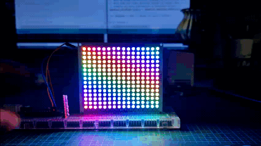

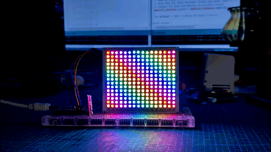

Step 11: CYCLON
Next, we use the FastLED library and open the cyclone sketch from its example menu.
Here's the sketch-
#include <FastLED.h>
// How many leds in your strip?
#define NUM_LEDS 240
// For led chips like Neopixels, which have a data line, ground, and power, you just
// need to define DATA_PIN. For led chipsets that are SPI based (four wires - data, clock,
// ground, and power), like the LPD8806, define both DATA_PIN and CLOCK_PIN
#define DATA_PIN 3
#define CLOCK_PIN 13
// Define the array of leds
CRGB leds[NUM_LEDS];
void setup() {
Serial.begin(57600);
Serial.println("resetting");
LEDS.addLeds<WS2812,DATA_PIN,RGB>(leds,NUM_LEDS);
LEDS.setBrightness(84);
void fadeall() { for(int i = 0; i < NUM_LEDS; i++) { leds[i].nscale8(250); } }
void loop() {
static uint8_t hue = 0;
Serial.print("x");
// First slide the led in one direction
// Set the i'th led to red
leds[i] = CHSV(hue++, 255, 255);
// Show the leds
FastLED.show();
// now that we've shown the leds, reset the i'th led to black
// leds[i] = CRGB::Black;
fadeall();
// Wait a little bit before we loop around and do it again
delay(10);
Serial.print("x");
// Now go in the other direction.
for(int i = (NUM_LEDS)-1; i >= 0; i--) {
// Show the leds
FastLED.show();
fadeall();
delay(10);

void DrawOneFrame( byte startHue8, int8_t yHueDelta8, int8_t xHueDelta8)
byte lineStartHue = startHue8;
for( byte y = 0; y < kMatrixHeight; y++) {
lineStartHue += yHueDelta8;
byte pixelHue = lineStartHue;
for( byte x = 0; x < kMatrixWidth; x++) {
pixelHue += xHueDelta8;
leds[ XY(x, y)] = CHSV( pixelHue, 255, 255);
void setup() {
FastLED.addLeds<CHIPSET, LED_PIN, COLOR_ORDER>(leds, NUM_LEDS).setCorrection(TypicalSMD5050);
FastLED.setBrightness( BRIGHTNESS );
