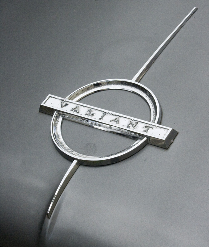

The ability of 3d printing to form any shape is quite remarkable. To be able to imagine a part, design it and then simply place an order online and have it arrive in the mailbox is amazing. Especially when the part in question could not realistically be made any other way.
Take for example these lock levers from my 1962 Valiant. The originals are a diecast aluminium and feature a very fine spline. I doubt they would be able to be manufactured any other way. Even with CNC machining I imagine the part would have to be made in two pieces if it was possible at all.
