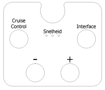

Step 3: Cut the Top Plate
Use a lasercutter to cut the top plate out of plywood 4mm.

Step 6: Add Electronics to the Wood Plate
Add the three LEDs to the wooden top plate, use some hot glue to secure them. Connect some female-female cables to the LEDs.
Solder some male-female cables to the four arcade buttons. Screw the arcade buttons in the wooden top plate.
