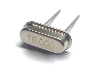

  • 16 MHz crystal -1

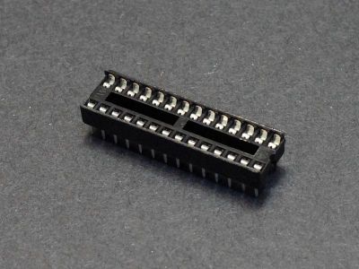

  • Ic bace(for atmega 328)

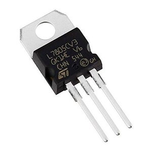

  • 7805 IC -1

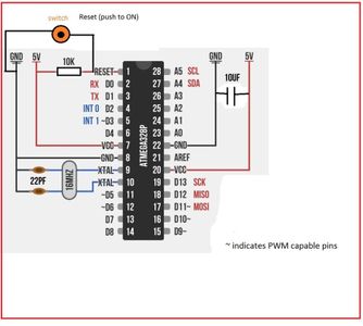

Step 3: Make the Circuit
Read the diagram and build the circuit.
It explains how to connect wires, components etc.
Place the components according to diagram on the dot board. Then check them again. After checked them, begin to solder the circuit.
Check where the components placed and how It will also help you just like the diagram.

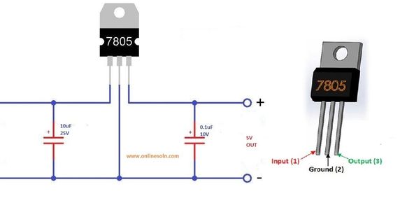

Step 5: Power Section
Add a 5v power regulator circuit to the project. So we can use it with a battery pack.
Check the circuit diagram and connect the 5v out put to VCC and GND pins of our Arduino.

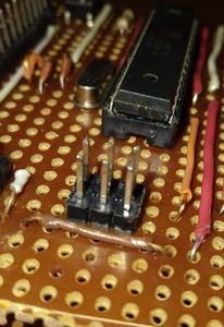

Step 6: Make Pins for Programmer
Now, Here we are going to program our board using a USB programmer and Arduino Software. So for that we are using six pins.
In here I'm explaining how to make that part.
For communication with USB programmer we are using MISO MOSI SCK RESET VCC and GND pins. these are the six pins I mentioned earlier.
If you look at a programmer you will notice that it Comes with six pins 3 for one line. So we need to make suitable port in our board.
Please check images.
Get pin header and break it to 2 pieces that include 3 of them in a one piece. and place them like in image and solder them. Now mark one side.(make it GND or VCC so it will easy to remember the side of your pins). Solder six pins to the Microcontroller. Then begin to make the connections.(check carefully images).

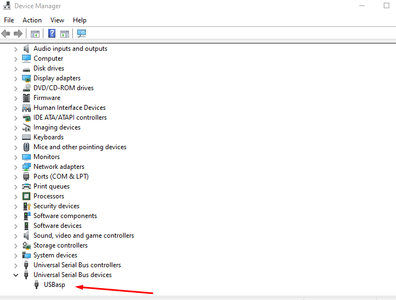

Step 7: Prepare the Programmer

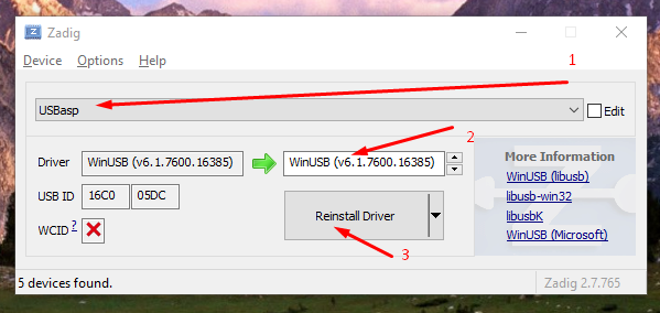

To Use the Programmer we need to Install some Drivers to our Computer.
For that go to this site :Zadig
Click on download.
After download it. Open it.
Plug the USBASP programmer to the computer.
Go to Options -> List all devices (tick on this)
Select Usbasp on the select bar.
Select the driver
Install it.
There are 6 drivers and to many people it worked only two of them. They were : . So I recommend to install one of them.
Then go to device manager. You will see A device called Usbasp that successfully installed our driver.
I included images of these steps.

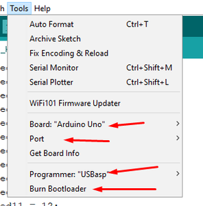

Step 8: Upload the Bootloader
If we want to work with our Arduino we need to install a Arduino bootloader. Its like our computer OS. It only need to install one time.
There are several ways to install bootloader to atmega 328 and you can find many tutorials from the internet.

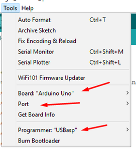

Connect the Programmer to the our board
Select the board as Arduino Uno.
Programmer as Usbasp.
In tools click the Burn bootloader.
This will burn the bootloader to our atmega328.

Open Arduino software and get the Blink example.
Note that you don't need to select the port since we are uploading our code using a programmer.
Then,
In Sketch click the Upload using programmer.
That's it! After you clicked on Upload using programmer, sketch will begin to upload to your board.
Finally you fill see a message called Done Uploading.
