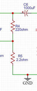

Step 3: Circuit Diagram
I got Circuit Diagram from the Data Sheet of Amplifier IC and did some changes to that. If you want to change the circuit keep remember the audio quality and gain depend on the components value.

Step 4: Circuit Explanation
Check the Images. You will be able to understand why we should use each components and what they do.
C8 and C7 are for supplying high currents during peak passages. Tt also reduces the power supply ripples.
C4 and R3 are to Upper frequency cutoff.
R4, R5 is to Setting the Gain.
C5, R6 control the Frequency stability
C6 is coupling the Output.
R7 is to control the Volume.
