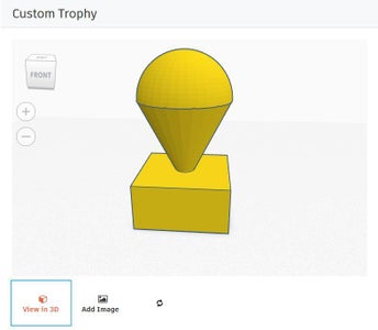

Step 1: Insert Box (Trophy Base)
First, you will insert a rectangular prism, or "box" as Tinkercad calls it, to serve as the base of the trophy.
Once you have added it to the workplane, make note of its dimensions. The one in this sample measures 20mm by 20mm by 10mm regarding its length, width, and height.
Step 2: Insert Cone (Trophy Midsection)
Second, you will place a cone into the Workplane to serve as the midsection of the trophy.
Once again make sure to make note of its dimensions. The one in this sample has a height of 20mm and a base radius of 10mm.
Step 3: Combine Box and Cone (Connect Trophy Midsection to Base)
Third, you must either rotate the cone 180° (shown in the image) or reflect the cone using the mirror feature to achieve the same effect.
Then, you must lift up the cone via the black triangle above the figure. The one in the sample was raised 6mm above the Workplane.
To conclude this step, attach the cone to rectangular prism base at its center. Make sure it is truly centered by looking at the composite figure that is the unfinished trophy from various angles. (You may use the icon at the upper left corner that is highlighted in the third image to do this.)
Step 4: Insert Half Sphere (Trophy Top)
Next, you insert a half sphere into the Workplane to serve as the top part of the trophy.
Its dimensions are not displayed on the side as usual, so this opens the opportunity to use the ruler tool with which you can view both height and the diameter of the half sphere. As seen in the image, the sample half sphere is 10mm in height and has a diameter of 20mm.
Step 5: Attach Half Sphere to Cone (Finish Assembling Trophy)
Finally, it is time to raise the half sphere to rest upon the circular base of the cone. These two figures should connect perfectly due to the half sphere's 20mm diameter which is the same as the diameter of the cone's circular base. (Recall that diameter is equivalent to twice the radius).
A little more math is lifting the half sphere to the correct height. Remember that the cone has been lifted 6mm and that the cone's height is 20mm. Taking the sum of both of these yields the height that you should raise the half sphere to for it to rest firmly atop the cone.
Remember to inspect the trophy from various angles to confirm that it has been completed.
