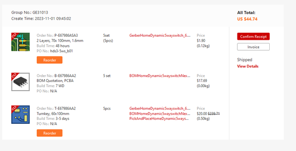

If you are good at soldering, you can print the PCB using any PCB manufacturer you like. However, as I am busy renovating my room, I don't have time to work on SMT soldering. Recently NextPCB approach me and ask if I am interested to accept a sponsorship from them and try their services. So I ask them if they could make the switch for me with their PCBA service.
The PCB gerber files can be found on my Git server over here.
https://git.imuslab.com/TC/HomeDynamicv3/src/master/hardware/hds_5-way-switch/pcb
Why NextPCB?
I personally do recommend their service as they do really have a great team of engineer to handle problems for you. If you are first time PCB maker and want to try all sorts of interesting design while making sure it is possible to produce, you can ask their engineer directly and they will give you recommendations on how to make it cheaper like sourcing alternative parts from China or how to pick another chip so it is generally faster to build.
They also help me to get this UR Mark that is really helpful if you are building commercial products.
Manufacturing
By uploading the Gerber file on NextPCB Gerber viewer, you'll able to see all the errors in order to make sure your design is ready for manufacturing. Feel free to try that out!
https://www.nextpcb.com/free-online-gerber-viewer.html
I ordered 5 pieces for my room which should be able to cover all my room's lighting and automation devices. After the boards arrive, you can start the 3D printing process and programming!

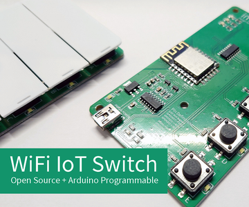

Step 2: 3D Printing & Installing Switch Panel
The step is quite straight forward. I designed a flexible PLA pieces that can be screw on top of the PCB to act as a front cover while provide enough flexibility so you can press the pieces and activate the SMD button below.
There are also tiny holes next to each of the switch so you can know if the press is registered or not. You can also program them to show the status of the device being controlled.
