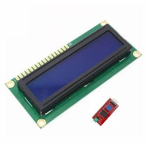

Step 1: Connecting the Lcd to the Arduino

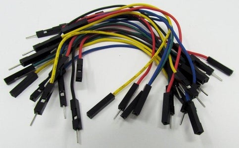

  1. Take the 4 wires and connect the male end to slots SCL, SDA, 5V, GND on the arduino
  2. Take the female end and match SCL to SCL, SDA to SDA, 5V to VCC, GND to GND on the lcd

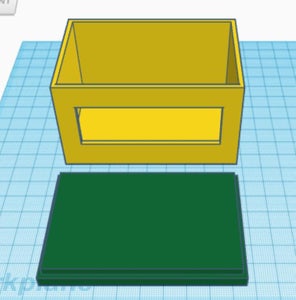

Step 3: 3D Printed Casing
  1. Now open your 3d designing software of choice.
  2. Design a box with these dimensions
  3. length = 9 cm
  4. width = 6 cm
  5. height = 5 cm
  6. Make a cutout in one side of the box with these dimensions
  7. length = 7.2 cm
  8. width = 2.5 cm
  9. Make another cutout for the dimenions of your cord.
  10. Make a lid for the box by making a rectangle with dimensions
  11. length = 9cm
  12. width = 6 cm
  13. Add a smaller rectangle on the bottom of the previous one that has the dimensions of the inside of your box depending on how thick you make your walls.
  14. Subtract the girth from each side from your dimensions of 9x6 cm
  15. This will make a lid that slides into the inside and its flush on the sides
  16. Now take your model and slice it in the software your printer prefers.
  17. Upload the sliced file to your 3d printer and begin the print.
