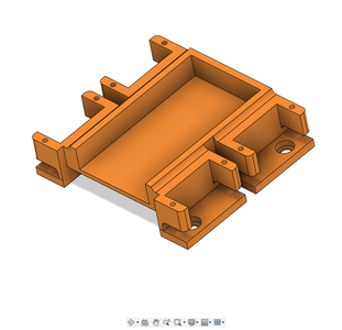

Step 2: Body Base
The base of the body supports the the four legs of the robot and has four servos fitted screwed in. By now the servo horns have all been fitted on the legs and after screwing in the servos to the body base its a simple matter of fitting on the legs keeping in mind to set the servo neutral positions initially. After fitting in the servos, the pins which support the joint should be pushed in from the bottom of the base.
