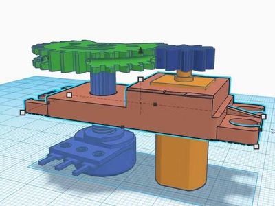

The Power of 3D Printing and Open Source
3D printing played a crucial role in creating custom gears and a precisely fitted housing for my electronics and motor assembly. Inspired by open collaboration, I am sharing my code, 3D models, and valuable lessons learned with the maker community. You can download the .stl here , and the codes can be found bellow with their descriptions.
