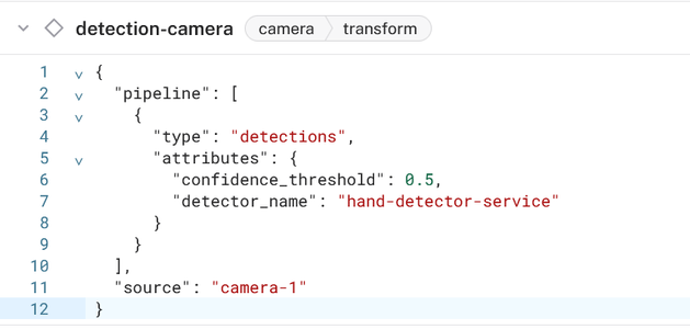

To test the model a 'Detection Camera' component is added with the following JSON configuration that defines the cameras overlay pipeline. In this case its looking for type detections with a confidence of over 0.5 (out of 1) using the detection service we just set up.
  "pipeline": [
      "type": "detections",
      "attributes": {
        "confidence_threshold": 0.5,
        "detector_name": "hand-detector-service"
  "source": "camera-1"

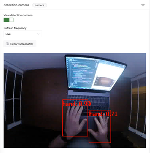

With that done. We can see that the detection camera shows us a bounding box overlayed when it detects some hands!

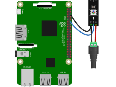

First problem was that Raspberry Pis give out 3.3V logic and WS281x LED strips require 5V logic, usually you use a logic level converter to pull-up the logic to 5V but I was out of the 74AHCT125 level converter chips I usually use so I implemented the quick and dirty trick of just... not using one (See diagram above). Thankfully, because electronic components are far more fuzzy and imprecise that what is expected in such an art, the short LED strip I was using worked OK with this trick but a level converter should be added soon as any longer of a strip and the signal is going to struggle to propagate to the end of it.
The data signal is connected to Pin 12 (GPIO pin 18) of the RPi4 GPIO pins as this pin has direct memory access (DMA) and can be used with some memory management magic to control an incredible number of LEDs without using all of the RPis resources. (2500 is my record!)
To power the LEDs a separate PSU needs to be used as the RPi4 can't supply more than the power of its own power supply to the 5V rail, which in this setup is 2A. (SAFETY NOTE: Never actually draw that from the 5V rail on any RPi though, as for one the RPi needs that itself and secondly you will likely damage the board). Most WS281x LEDs draw around 60-100mA (depending on if has an extra White LED on chip and other factors) at 5V EACH, a hefty amount of current that adds up when you have 60 per meter on a strip. In this setup it was drawing about 4-5A at full all-on brightness so a 5V 10A rated power supply was used. (SAFETY NOTE: Keep in mind the gauge of your wire when designing these higher current circuits!). Remember to also unify the Grounds of the RPi and the LED strip by connecting them together. Using the Gnd Pin next to GPIO 18. (See picture above).
