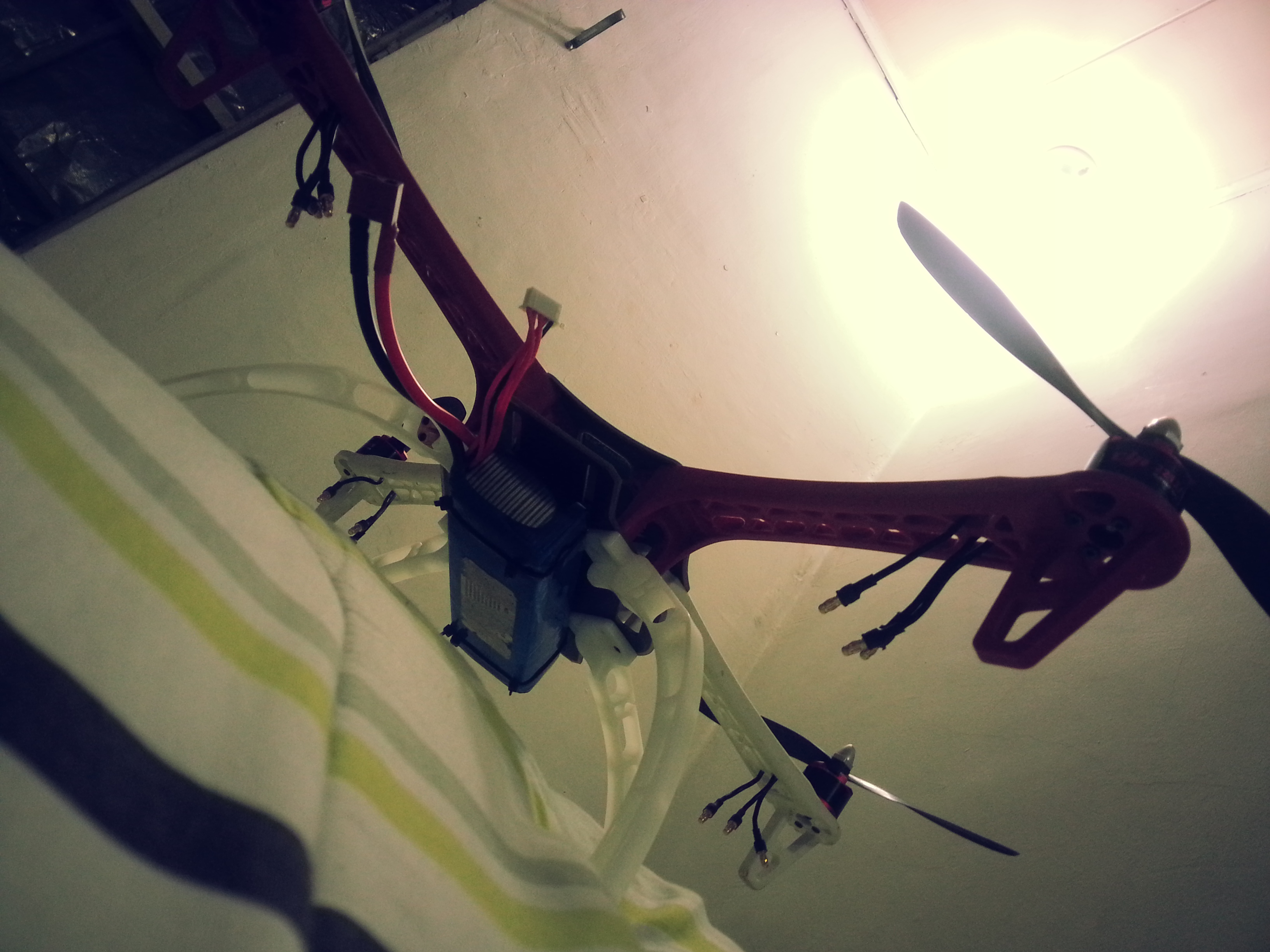

Step 9: Replace That Old Flight Controller
Let lessen the detail and just get to the point here
Replace your old flight controller in my case CC3D
Install your DIY Flight controller
Position your Magnetometer somewhere on the frame wherein its not affected by the motors or battery.
For Bluetooth Programming replace the FTDI programmer with an HC 05 or HC 02 Bluetooth module Note that some BLuetooth modules need to be reconfigured to 115K baud for it to work
