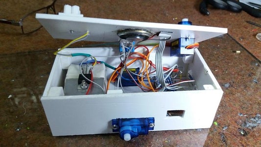

Home made robot partially 3D printed. .It is based on arduino nano board, servos, ultrasonic sensor and LDR resistors.
It has 4 modes:
- Manual control by IR remote ( forward, backward, right and left)
- Autonomous mode ( ArduBot navigates to avoiding obstacles and choosing the best way.)
- Monitor mode ( ArduBot is monitorng objects in front of the ultrasonic sensor. )
- Line tracking mode (I added this mode to the original design )
