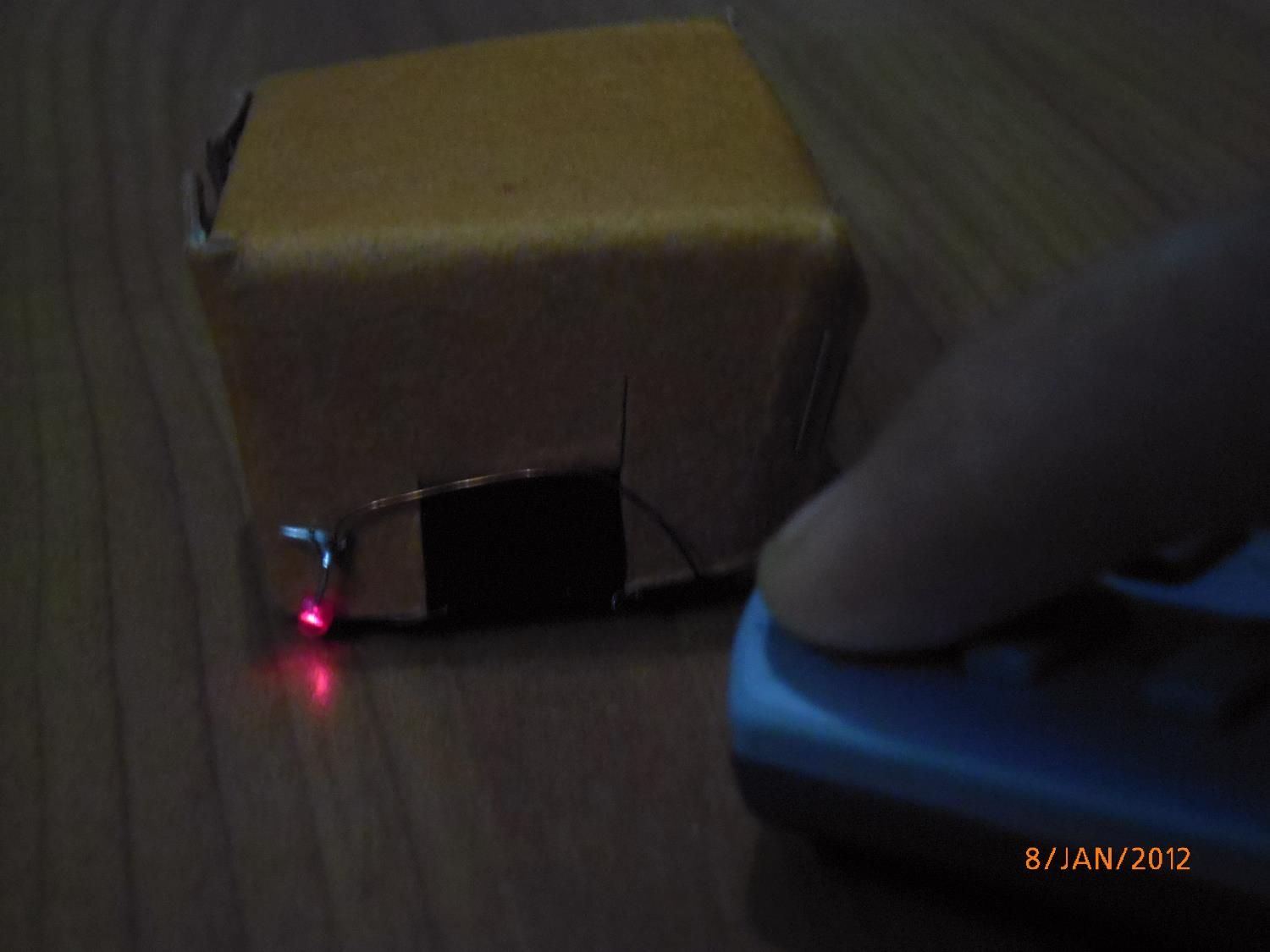

Step 5: Making the Emitter
Now you have all stuff you need. It's time to move on and start making the emitter. The circuit is very easy to make .But if you want to skip this circuit making step you could also buy one FM emitter from here:http://electronics-diy.com/store.php?sel=kits&sub=fm_transmitters. If you do so no need of making the given circuit. Now move on to the circuit: This is a one transistor circuit . Before making you must draw a rough diagram.Now you have to go for power. This emitter can be powered by a 3-6v battery or a USB 5.0 V constant voltage for powering it with USB  you have to use a USB 2.0 male plug and it's polarity is given above in the image.(Just click on the images for magnifying the image)Solder the plug in the prototyping board and be sure about the polarity. Now make the circuit with extra care if you are using SMD'S.Connect the 3.5mm jack with a 3-core wire and solder it on the prototyping board being sure about the negative terminal of the jack goes to the ground of the circuit. and the two other wire will go to the input of the circuit. .Now you are going to make the inductor. This inductor is the most curious part of the circuit.This inductor is winded by a 18 - 22 gauge wire and there are four turns and the antenna is tapped at # 2 turns and the antenna is connected to the tapped wire . Initially there are Three wires coming out from the inductor .The two at the end are connected to the circuit and the middle one is connected to antenna If you are an beginner just know that a 18 gauge wire is around 1.024mm in diameter or please refer to this link:http://en.wikipedia.org/wiki/American_wire_gauge.You can use a long wire or small antenna for the antenna.You emitter is ready . Use a mobile phone FM application and check all the frequencies. You will get your frequency. I had uploaded the video .You can make 4p7 capacitor by putting capacitors in series e.g:15p :: 7p.Now you have finished making it and then you can case it so the inductor does not catch any damage i have used and angry bird MP3 player's casing.The image is given above.That's all the emitter is complete.
