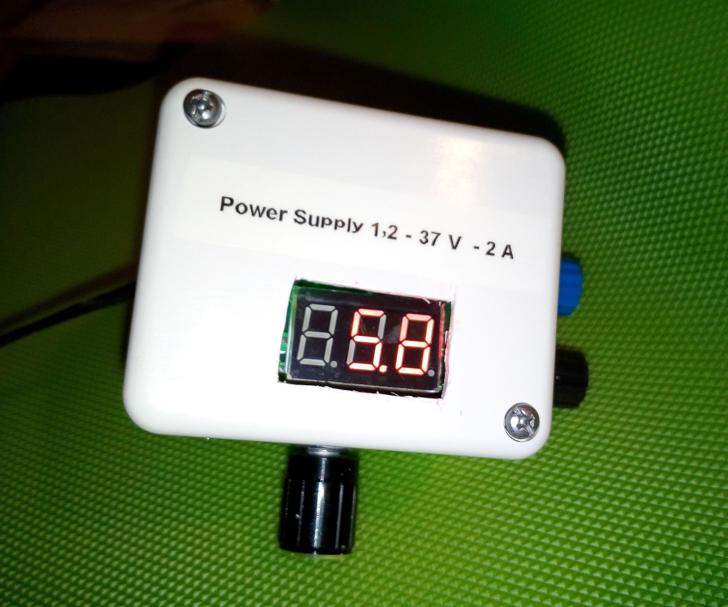

Step 2: Let's Start
- The first thing to do is remove the two 10 Kohm trimmers.
Looking at the board holding the two blue trimmers toward you, the left one adjusts the current, and the right one will allow you to adjust the voltage
With the trimmers removed we will going to to connect the two potentiometers.
Here we will attach three wire strings to each one.
This wire does not need a particular diameter, but to facilitate welding to the board it will need to be fine enough
For those of you who will chose a 10-turn potentiometers, be careful that the variable terminal is the number
2. With the old PC power supply disconnected from the CURRENT, go cut the output cable leaving a sufficient wiring harness, clear the poles and go check it with the multimeter the positive pole and the negative.
DO NOT FIDE the colors of the wires
Identified the poles you can go to connect them to the DC-DC Board.
Tip: Inputs and outputs are marked on the back of the board. I suggest you write them over.
It will come back util to you in the cabling phase
3. Now also connect the DC 100V 10A Voltmeter Ammeter.
If you have purchased a digital model, this will also be powered, so you will find it With two wires + and - to connect to the board input and three other wires to connect to the output of the three wires in the following way
Red -> Out (+)
Black-> Out (-)
Blue -> will be connect to the bush (-)
Check the wiring once again and when you are sure, switch on the power.
4. You will notice that the board is also equipped with some led. One on ignition, another telling you that the load is connected and the third will indicate the short circuit or Is working the current limiter Try adjusting the potentiometers to make sure that you have connected them properly and that the voltage and current are adjustable
At this point we can switch to inserting our laboratory power supply into a box. The size depends on the PC power supply that you are using, too If you may decide not to put it in the container but leave it outside
Ok let's go!
Take the caliber and measure the diameter of all panel components. Usually the bushes need a 6 mm hole and the potentiometer of 8 mm I miss you the task of finding the smartest way to do the holes for the measuring instrument you have chosen. Connect everything calmly and without hesitation.
WARNING: The output connection wire should have a sufficient diameter to carry the 5A, so my advice is to recycle a piece of cable That you cut off from the laptop power supply
To lock the board and the laptop power supply in the box you cane use the hot glue.
Close everything and label the basic information on the front panel; Adjustment of current, Adjustment of voltage, and max voltage and maximum current available from your new laboratory tool!
And now is the time to admire the result of your work.
