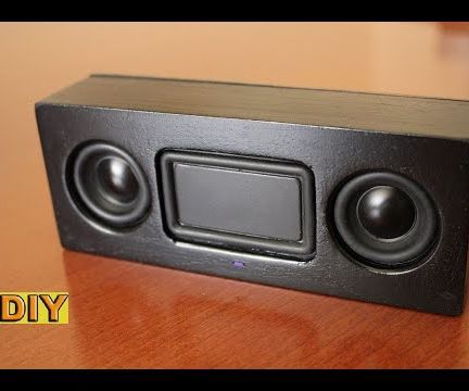

- 1 inch/27mm 3 watt speakers.
- 3.7V 2000mah battery with integrated pcb.
- Audio module ct14+ less powerfull version.
- Plug in to PC to act as external sound card.
- Width 6.5cm, height 4.9cm, depth 4cm.

-Place the speakers with a little bit of glue on the exterior part of the speaker, it will be a perfect fit has the exterior part of the speaker will enter in the hole.
-Remove the speaker connecters and solder the speaker wires directly in the board.
-Secure the board and batery with hot glue, cut the wires and conect the batery red wire to the switch, close the case and lets try it.
Step 8: Test Time
The sound its clear, louder and with more quality than any smartphone, found it that if connected to an usb cable to the computer will act as a sound bar or exterior sound card :)
I´m happy with the final result, check the video in the beggining of this instructable to see it playing.
