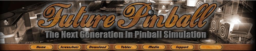

 As I mentioned before, this is a standard PC with installed special Pinball emulation software. In my case they are: "Visual Pinball" and "Future Pinball" Emulators. The buttons are mostly used to control the software, but I also use little wireless keyboard-mouse combo to set up some advanced functions. I should mention that a very useful option is the use of so-called Frontend software, so if we put this software in the Startup of the operating system, we perform all controls only with the buttons. In order to use this convenience, it is necessary to perform all the settings beforehand, which is not a very simple operation, especially for a beginner, but that's why there are many detailed videos and tutorials for these settings.
