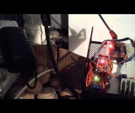

Let's start creating a moving platform. We will use Arduino Nano as the controller. Connection diagram
Step 3:
Here's how it turned out
