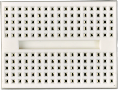

  1. a breadboard
  2. a mini size can sync 3 devices
  3. a half size can sync 6 devices

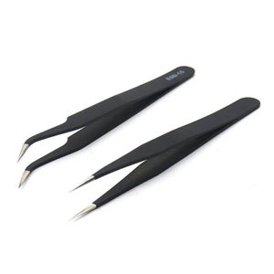

  9. A good tweezer is recommended, it will really help when adding the wires

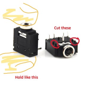

  • If you use the half size breadboard you can remove the power rails, you don't need them and it interferes with the audio jacks.
  • Not really necessary but I highly recommend to cut the little plastic feet from the sides of every audio socket to make it sit flush with the breadboard.
  • Please be careful not to cut yourself. Also I really recommend when handling these audio sockets to grab them by top/bottom, not the sides, it can easily flip and poke your fingers with the pins. Learned that lesson after stabbing by fingers a couple of times. 😅
