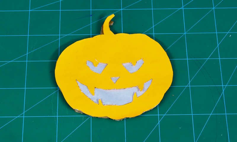

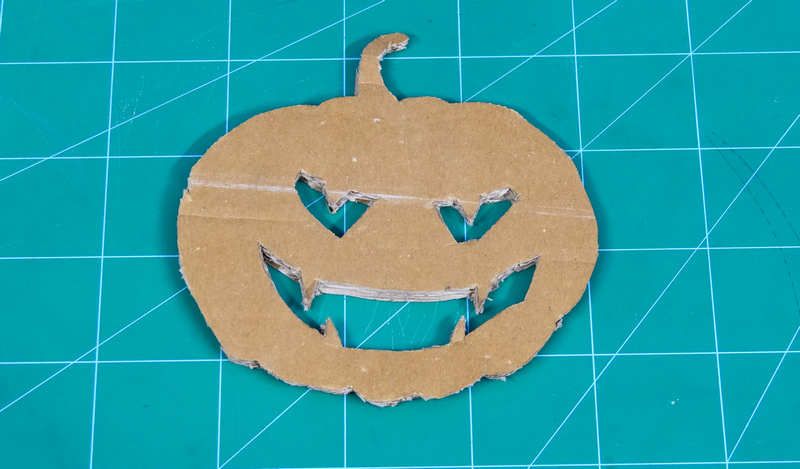

We are going to make the pumpkin out of cardboard or you can use even a real pumpkin.
- Take the cardboard and cut it in the shape of the pumpkin.
Step 3: Adding the Scary Touch
This pumpkin won't scare the people. We need something more.

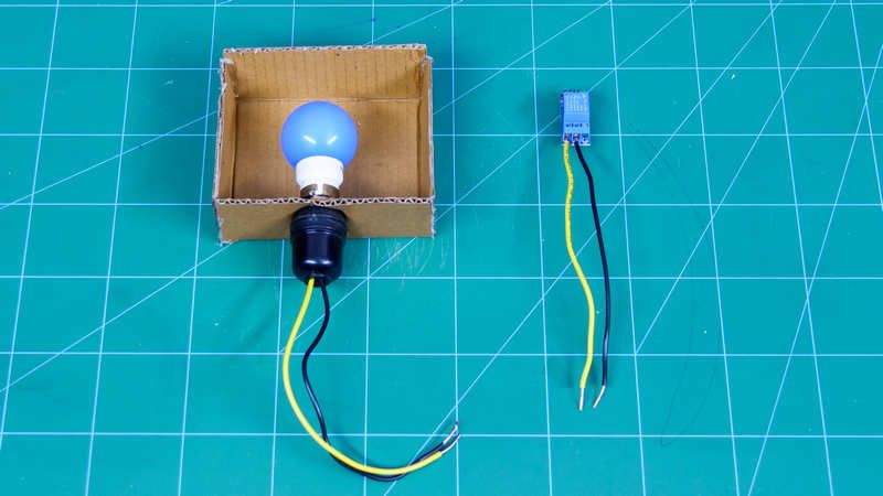

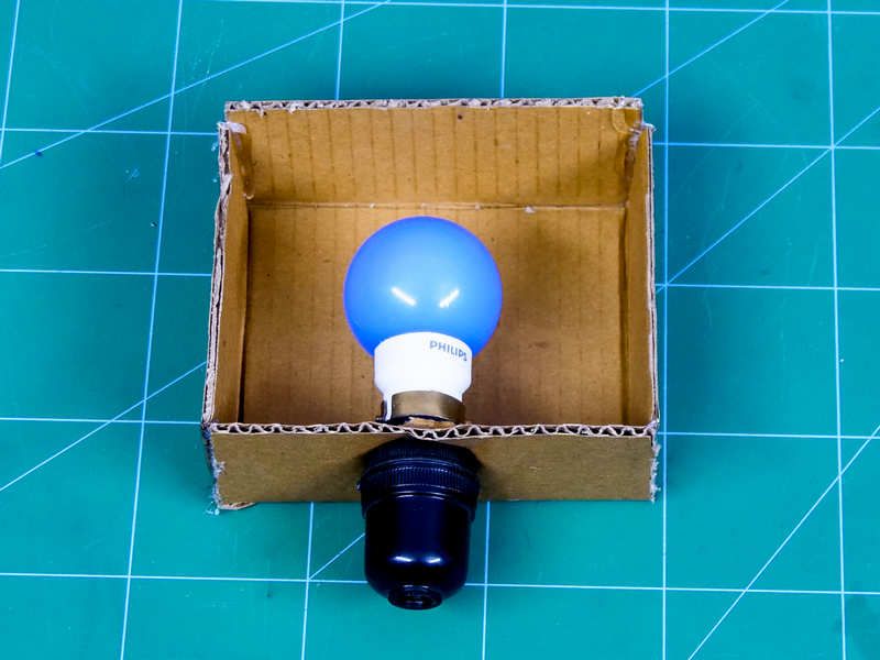

Something like a glowing pumpkin when you go near it. Thus, to make it glow we need to add lights. We are going to use the bulb for this. Make a box out of cardboard if you do not a ready-made box. This box will be the house of the bulb and relay(switch).
Insert the bulb holder through the bottom side and insert bulb in the bulb holder.
Alongside the bulb place relay too. Glue this box on the backside of the cardboard.

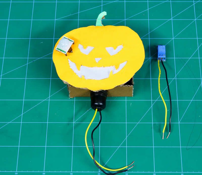

It's time to introduce the hero of the project that is the PIR Sensor. This is the one that will detect the presence of anyone near your pumpkin.
Attach the Sensor on the front side of the pumpkin and pass its wires through the hole. As we are going to make all the connection on the backside.
NOTE: If you are using a real pumpkin, you need to make sure that the Sensor is not covered.

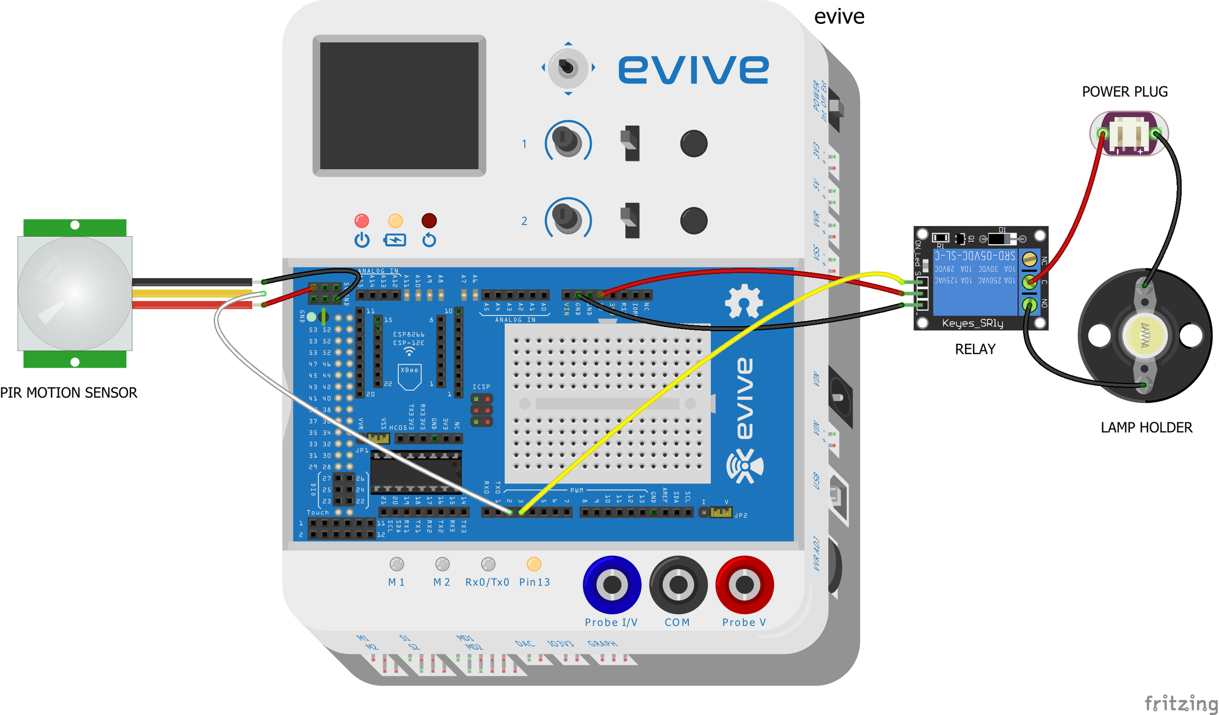

Make the connection as follows.
And upload the following code.
You can download evive library by clicking the link here.
To know more about Arduino visit here: https://thestempedia.com/wp-content/uploa...
Thus when PIR detects the presence of the human, the relay connected to the bulb gets triggered switching on the bulb. To make it more dramatic we are turning the bulb ON and OFF a number of times. Also, to add more effect, we have programmed the inbuilt buzzer in evive so that it will generate the spooky sound we want that syncs with the lights.
