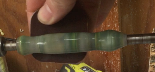

Step 1 - Drill out the center of your blank, i find drilling on the lathe always hits dead center.
Step 2 - Mount on the Lathe. I mounted it on my pen mandrel, if you prefer to turn between centers that's fine.
Step 3 - Turn down the material to your desired shape. I mostly used a roughing gouge, and a carbide tool for finishing
Step 4 - Sanding. Everyone's favorite step. For acrylic pieces, I wet sand with 600 grit paper and then move to micromesh sanding pads which go up to 12,000 grit.
Step 5 - Polishing. I use a friction polish to bring out the final shine.
