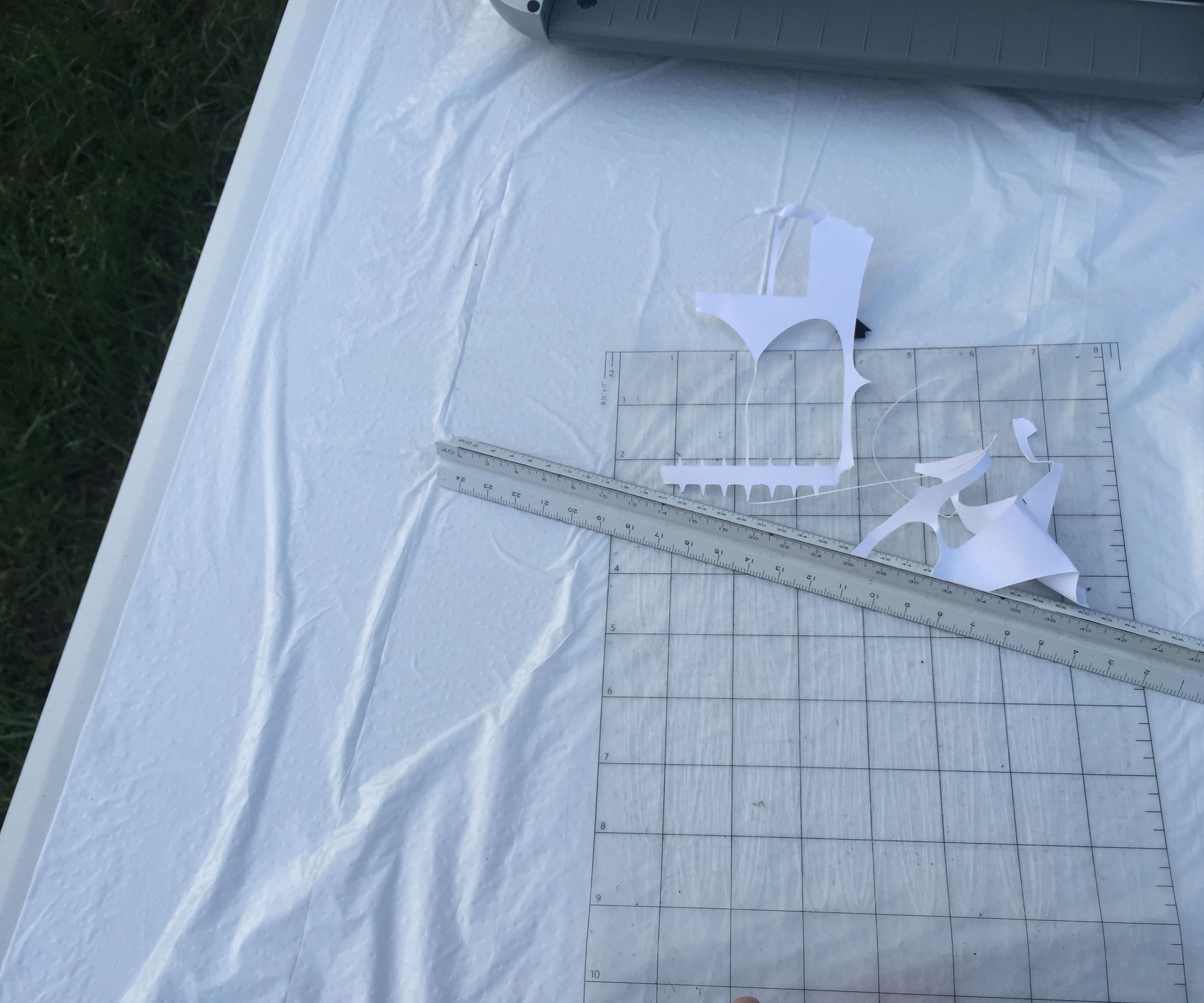

Step 2: Prep Mats
- Use a straight edge and marker to mark the center of the mat and cut in two along the line.
- Using the original cutting mat as a guide trace the cutting area on each mat. Cutting area is 3/4" from top and bottom and 1/2" from each side.
- Tape the edges with masking tape along the lines marking the cutting area. Leave the cutting area clear.
The place mat I bought measured 12" by 17" which will make two 8.5" by 12" mats. This is smaller than the silhouette mat, 9" by 13.5". This size will still fit the Silhouette Portrait machine with a slightly shorter cutting length. If desired a full sized mat can be cut out; I made two for comparison of the adhesives.
